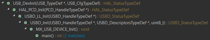

The problem was that after boot, when calling MX_USB_DEVICE_Init() with VDDUSB not present (usb not plugged in), the program was endlessly interrupted and stuck in USB_IRQHandler(), after calling USB_DevInit() in HAL_PCD_Init() in the file stm32l4xx_hal_pcd.c.
The problem never occured when VDDUSB was present (usb plugged in).
Here's the call hierachy :

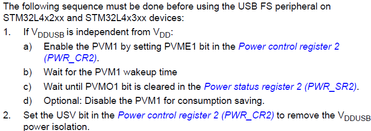

Reading the Reference Manual RM0394, it's mentioned page 137 : 0693W000003Qp6EQAS.png
As specified in the title, MX_USB_DEVICE_Init() never follows this sequence before removing the power isolation by setting the USV bit in PWR_CR2 by calling HAL_PWREx_EnableVddUSB(). The PVMO1 bit is never checked, which surely caused problems in further USBD initialization.
Call hierachy :

  • When running the code generated by the joined ioc file : the execution is stuck because it's endlessly interrupted by USB_IRQHandler() after reaching a specific step in MX_USB_DEVICE_Init() (specific step which is detailed in the 1st call hierarchy screenshot of the original post).

  • the VDDUSB power isolation is removed (2nd call hierarchy screenshot in original post) without checking if VDDUSB is set or not (as it should be as specified in the Reference Manual RM0394 page 137, once again screenshot provided in original post).
