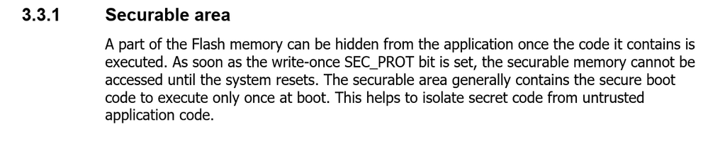

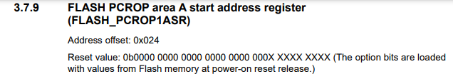

seems the "protection unit" is here, but a very simple level:
so there is no special "MPU-unit" to activate in Cube, just some registers for flash protection:
