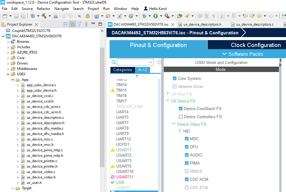

Could you please advise what to do to make the environment generate audio files?
Could anyone of you show me how to generate these files?
They are generated for all classes except audio.
I guess there should be these too.
Alternatively, please show me how to create an AUDIO Device using the STM32H5 processor.
Please for the msc class even adds
storage_configuration_number = USBD_Get_Configuration_Number(CLASS_TYPE_MSC, 0);
storage_interface_number = USBD_Get_Interface_Number(CLASS_TYPE_MSC, 0);

About USB Audio files missing in the generated code, the issue is solved in STM32CubeMX 6.17.0 version.
Thank you.

Hello @konsul41 ,
Thank you for your bringing this issue to our attention.
I reported the audio files issue internally.
Could you please give more detail about the MSC issue?
-->Please for the msc class even adds
I found this code in app_usbx_device.c file
/* Get storage configuration number */
/* Find storage interface number */
