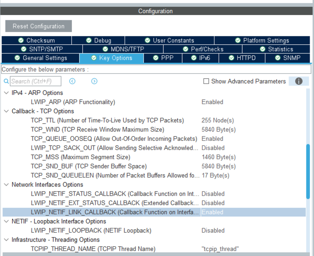

2022-12-07 6:00 PM
Please check the version of HAL Library.
If you use v1.10.0, it included bug in link callback function.
(it is possible to improve using updated HAL Library as v1.11.0)
You should enable for Link Callback in LwIP Key Options.
Check the code of the ethernet_link_thread() function in the ethernetif.c file
if(linkchanged)
/* Get MAC Config MAC */
HAL_ETH_GetMACConfig(&heth, &MACConf);
MACConf.DuplexMode = duplex;
MACConf.Speed = speed;
HAL_ETH_SetMACConfig(&heth, &MACConf);
HAL_ETH_Start_IT(&heth);
netif_set_up(netif);
netif_set_link_up(netif);
You need to change the initialization function to _IT() as shown below.
HAL_ETH_Start(&heth); -> HAL_ETH_Start_IT(&heth);
Best regards.
