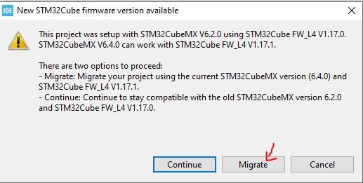

CubeMX invited me to migrate my .ioc from 6.2 to 6.4 and FW_L4 from 1.17 to 1.17.1

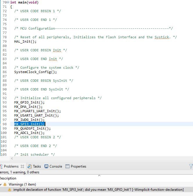

After that I have a warning Implicit declaration of MX_SPI3_Init in main.c
This is only in cubeMX generated code

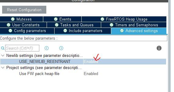

For information cubeMX asked me to enable USE_NEWLIB_REENTRANT in freertos0693W00000JNo2YQAT.jpg
What could I have done wrong?
How to fix this error of cubeMX, which does not include spi.h in main.c?
0693W00000JNo1zQAD.jpg0693W00000JNo1pQAD.jpgThanks in advance
PS : I specify that I have for the moment avoided the problem by adding :
#include "spi.h"
/* USER CODE END Includes */
Here I want to correct the original problem that forces me to do this.
