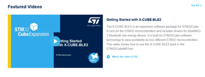

See the video: Getting Started with X-CUBE-BLE2 at the bottom of the page:
Hope that helps.
Hope that helps.

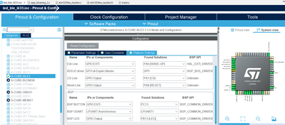

I am testing the Nucleo-L433RC-P board with a BlueNRG-2 BLE interface. I configured the setup, but the BLE device is not being detected in the ST BLE app. Look at pic, Any modifications require are not ?
Hello @Kumar123
I think the original question has been answered. Please close this thread by accepting the comment that answred that question and open a new thread for that issue.
