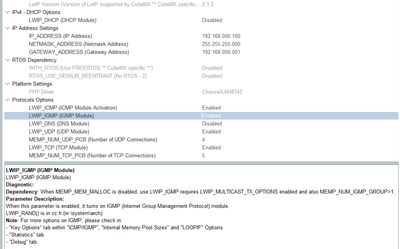

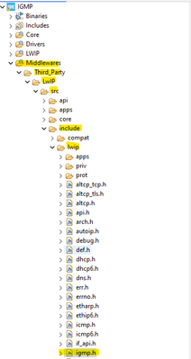

Do you mean that you can't see the igmp.h file in middlewares?
The igmp.h file is generated when using STM32CubeMx6.14.1 as shown in the below figure.
Could you please try with the latest STM32CubeMx version?
Thank you.
