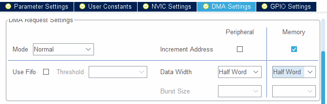

After changing a parameter to "Half Word", that signal was output as I expected. Thank you so much.
