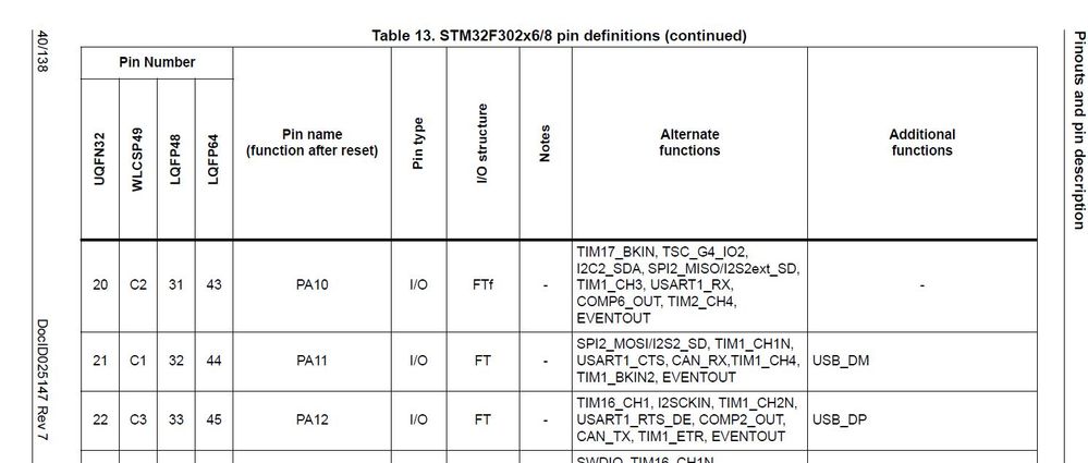

DocID025147 Rev 7, Table 13 shows that USB_DM and USB_DP must be initializing as Additional functions. It doesn’t work.

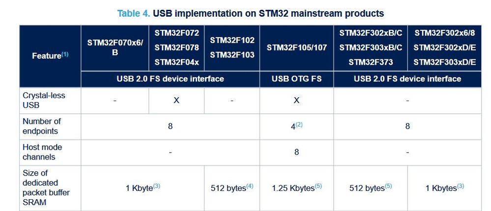

Document AN4879 "USB hardware and PCB guidelines using STM32 MCUs", Table 5 shows that STM32F302x6/8 has 1024 bytes SRAM.
But I have access only to 512 bytes.

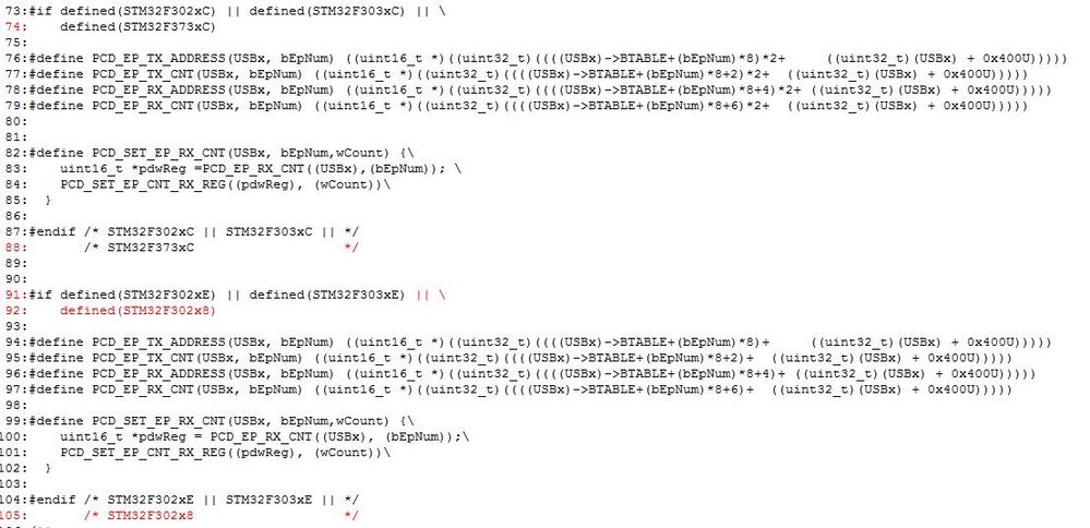

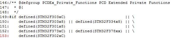

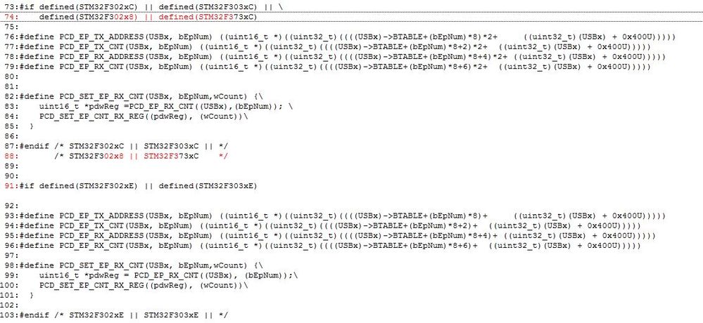

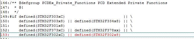

After I configured USB_DM and USB_DP as alternative functions AF14 and changed defines (for use 512 instead 1024) in stm32f3xx_hal_pcd_ex.h from
to
and in stm32f3xx_hal_pcd_ex.c from
to
USB CDC began to work OK.

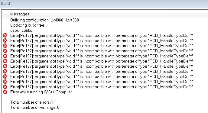

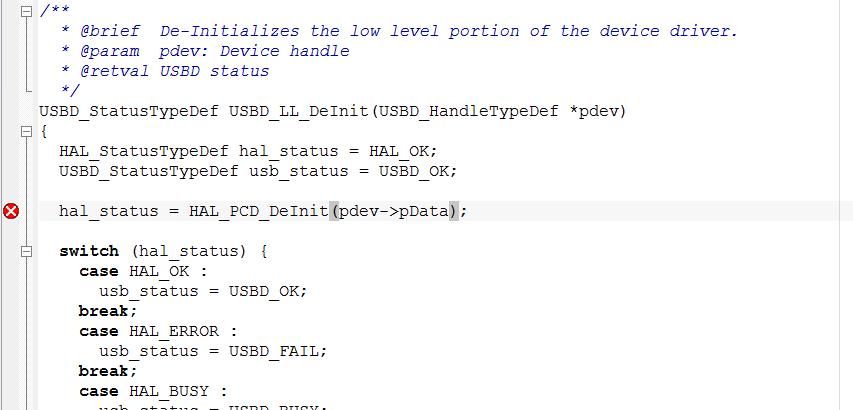

3. Additional STM32CubeMX generates source code for USB CDC with errors, see pictures
I fix it each time after STM32CubeMX generated source code, it is not comfortable.
