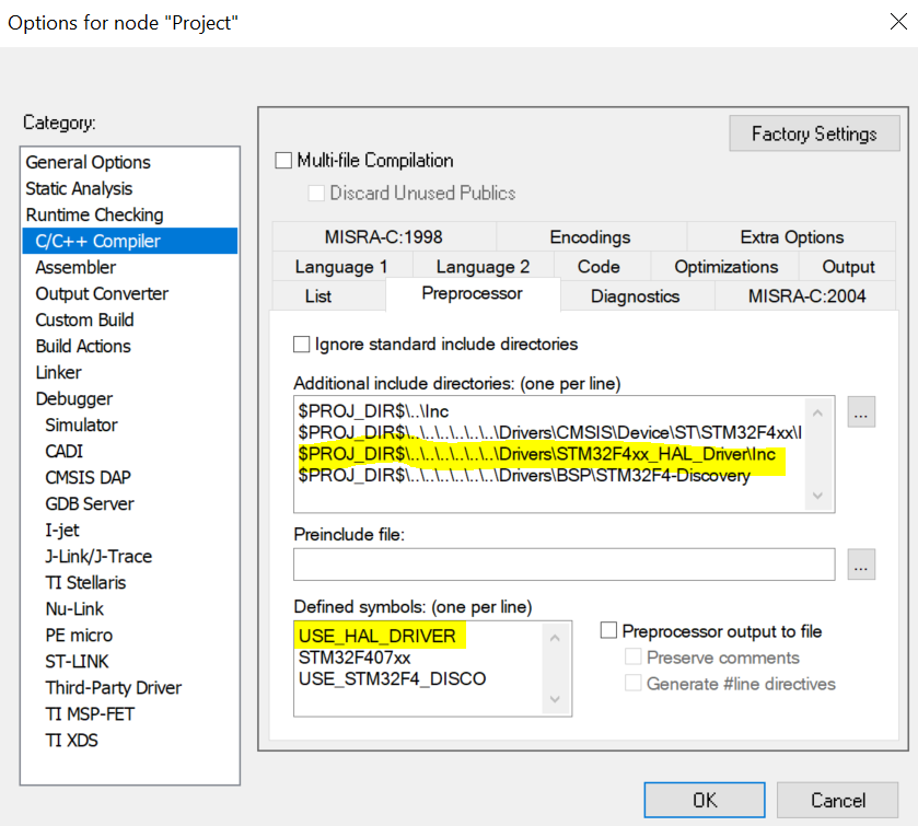

A first look at the problem seems to be that IAR is not able to read these files even though they are existing.
I can suggest you add them to your workspace one by one, or if they already exists try delete them and adding them again from the path they exists.
Another solution is to verify if you include the path for theses files from the IAR options: go to c/c++ compiler ==> preprocessor, in the "additional include directories" put the path for these files. Also in "Defined symbols" box make sure you are using the HAL driver (USE_HAL_DRIVER)
I did attach an example for the F4 to show you. Hope this help to solve the problem.
