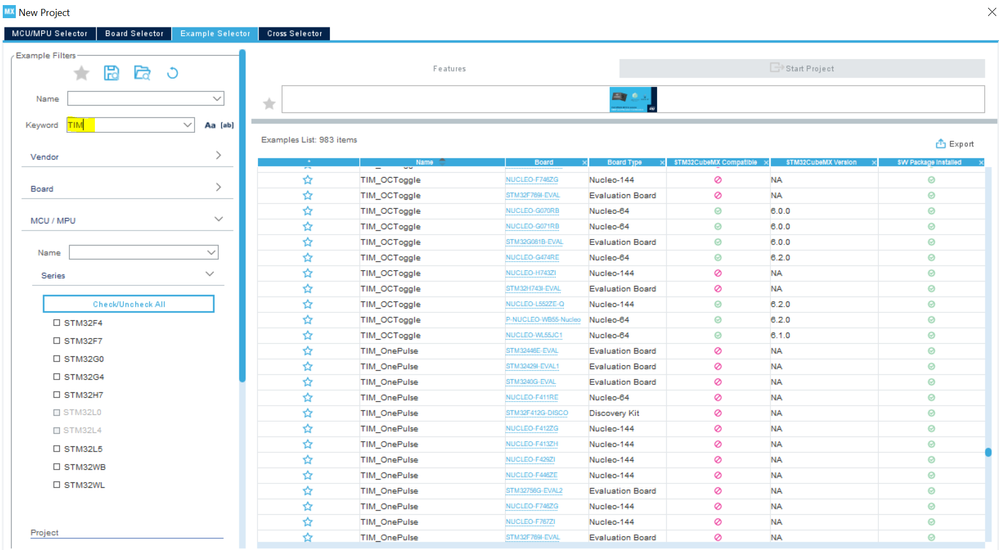

In fact, STM32CubeMX tool comes with the Example selector feature allowing you to browse a large set of examples and to start a new project from a selected example for some STM32 MCUs/MPUs. Thanks to the filter panel it is possible to filter down the example list (you can use TIM/ timer as a keyword):

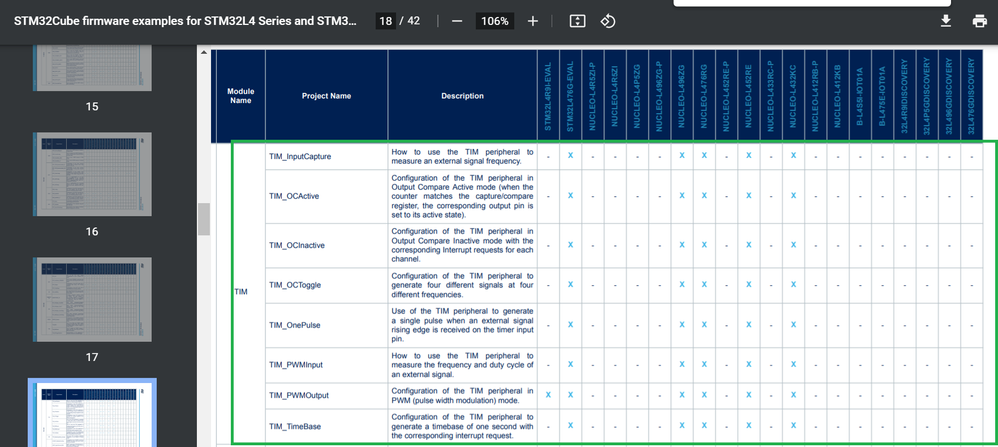

Otherwise, you'll find a table resuming the available examples in the STM32Cube MCU Package examples for STM32L4 Serie Application Note:

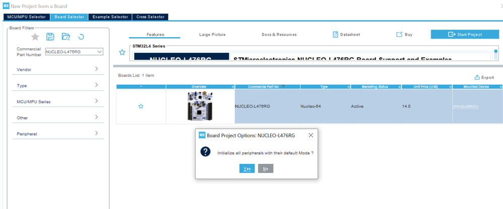

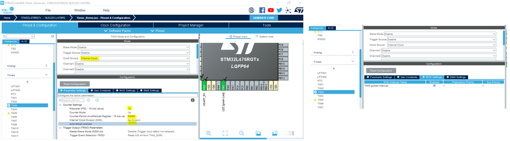

Trying to directly answer your question; configure timer 3 for 40ms interrupts in STM32L476, you'll find hereafter some simple steps to de the configuration using CubeMX:
/* USER CODE BEGIN 2 */
HAL_TIM_Base_Start_IT(&htim3);
/* USER CODE END 2 */
/* USER CODE BEGIN 4 */
void HAL_TIM_PeriodElapsedCallback(TIM_HandleTypeDef* htim)
HAL_GPIO_TogglePin(LD2_GPIO_Port, LD2_Pin);
/* USER CODE END 4 */(I've used LD2 as the PA5 is the output for green Led)
Normally following those steps everything will work correctly.
