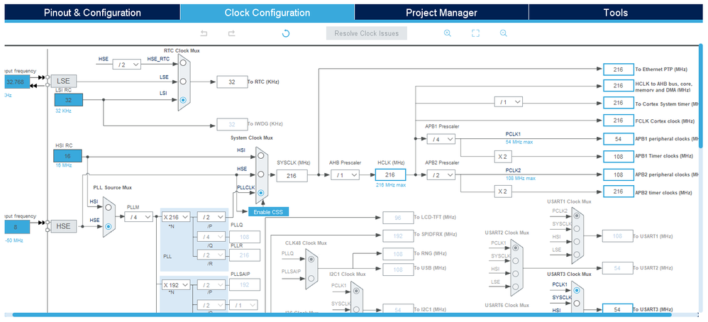

This is my clock configuration.
This is setting for TIM1,

2019-09-20 4:06 PM
Use TIM2, set the Period to maximal, ie 0xFFFFFFFF
Set the prescaler to the clock frequency MHz-1
ie 99 for 100 MHz TIMCLK
Then CNT will count off in microseconds.
You could also use DWT_CYCCNT to time things in CPU cycles.
