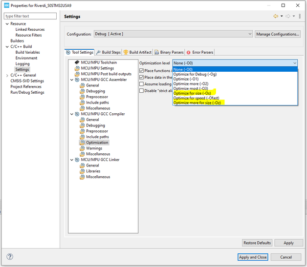

You can activate the optimization option as shown in the below figure.
In this case the compiler will attempt to improve the performance and/or code size at the expense of compilation time and possibly the ability to debug the program.
Therefore, when debugging the execution will not be in line with the written code.
I recommended that you check this link: Optimize Options (Using the GNU Compiler Collection (GCC))
