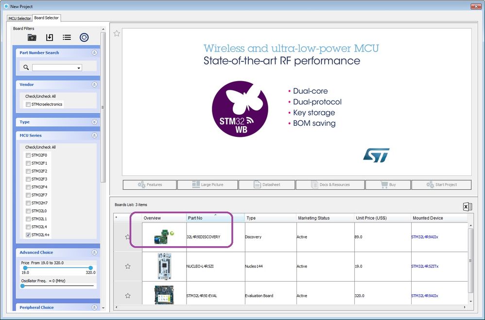

I found how I could use pins PG7 and PG8, so that part is resolved. However, I still cannot get CubeMX to add in the STM32L4R9i-DISCO board. I need to use the PG7/PG8 pins for the accelerometer. But I would like to keep the rest of the peripherals functional, so I want to have the current board layout when working on CubeMX. This means that I cannot just select the MCU on CubeMX but would need to select the board itself.
I don't know what you're doing, and not an CubeMX user myself. You need to load the libraries into the repository, and the STM32L4R9I-DISCO is listed under available L4+ boards.
BSara
Associate II
@Community member​ This is exactly what I needed. Thanks so much! For some reason they decided to name this part without the STM prefix, so it was very hard to find.
