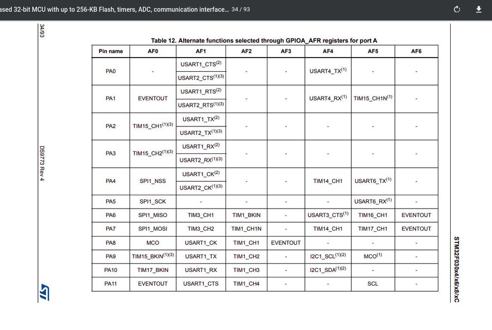

For example, in order to configure STM32F030F4Px's PA3 as USART1_RX, I need to set the relevant Alternate Function nibble to "1", as stated in datasheet.

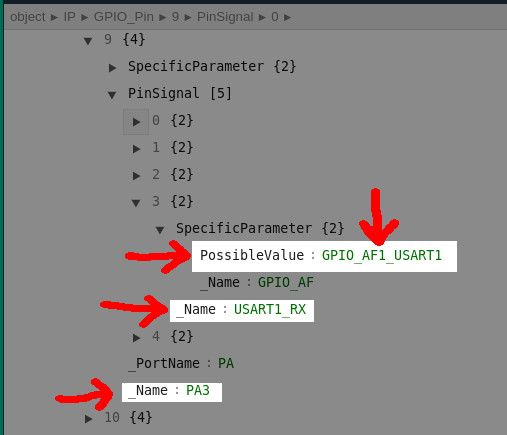

In the file mcu/IP/GPIO-STM32F031_gpio_v1_0_Modes.xml, there is a structured data at: IP.GPIO_Pin.9 indicating the following:
This allows me to conclude that I need to set AF1 in order to configure PA3 as USART1_RX. However, this information is inside a file named *STM32F031*.xml where I'm interested in STM32F030F4Px.

mcu/STM32F030F4Px.xml: <IP ConfigFile="GPIO-STM32F0xx" InstanceName="GPIO" Name="GPIO" Version="STM32F031_gpio_v1_0"/>
I was just looking for exactly the same thing and then found your post. From the looks of it, your posts seem right, by using the `<IP>` tag you can find which GPIO config file to parse, and then I expect that the signals from e.g. `STM32F030F4Px.xml` should match the ones in `GPIO-STM32F031_gpio_v1_0_Modes.xml`. Note that the latter seems to add info on the AF needed, but the former includes signals that have no AF mapping such as ADC assignments.

STM32F031_gpio_v1_0_Modes.xml is a dead end (or I couldn't figure out how to interpret it). Can you use that file to obtain AF mappings?

And then in GPIO-STM32F031_gpio_v1_0_Modes.xml, find the corresponding data:

Now, if you want to want to know the AF mapping for e.g. USART1_CTS, you just look at the PinSignal entry for that, find the GPIO_AF1_USART2 there, and extract the "AF2" part.

It seems you still need the second file, since that defines which signals are available exactly on this pin on this chip, while the second file defines a lot more signals, probably the union of available signals on this chip for all chips from this particular family.
