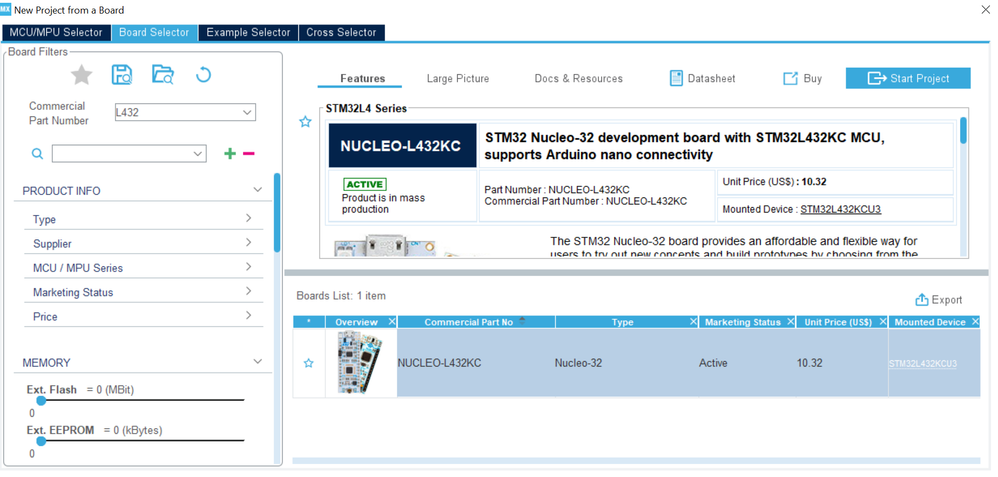

I will use an ST Nucleo-L432KC for this demonstration, as it’s small, fits on a breadboard, and still has a powerful ARM Cortex-M4 core. You are welcome to use any STM32 part, but I generally recommend starting out with one of the Nucleo boards.
Plug your STM32 part into your computer.

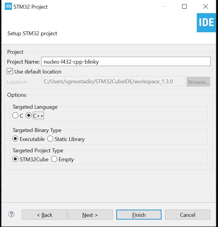

Start STM32CubeIDE[link] and select File > New > STM32 Project. Select your target microcontroller or board (I’ll select my Nucleo-L432KC).
Click Next and then give your project a name. I like to prefix the board I’m using to the project name, so nucleo-l432-cpp-blinky is what I called mine. In Targeted Language, select C++.
Click Finish and click Yes when asked, “Initialize all peripherals with their default Mode?�? Click Yes to open the new perspective.
Leave everything as default on the CubeMX device configuration GUI.

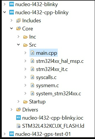

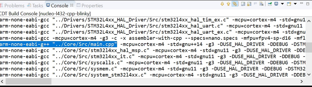

Code should be automatically generated. However, CubeMX generates a main.c file, which is not what we want for a C++ project. Right click on <project name> > Core > Src > main.c and select Rename. Change the name of the file to main.cpp. The compiler is sensitive to file suffixes, so .c files will compile as C code and .cpp or .cc files will compile as C++.

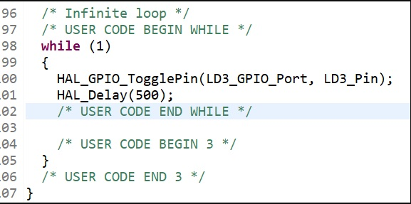

Open the main.cpp file associated with the project. Scroll down to the while (1) loop and add the following code just inside the while (1) loop:
HAL_GPIO_TogglePin(LD3_GPIO_Port, LD3_Pin);
HAL_Delay(500);Note that the GPIO port and pin names might be different for your board. If you’re using a Nucleo-64,
In case you are wondering: yes, this is still C inside of a C++ file. Most of the STM32 HAL libraries are written in C, but they’re safe to call in C++.
Save and click Project > Build Project. You should notice that any .cpp or .cc files get automatically built with g++.

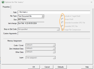

2024-02-04 9:55 AM - edited 2024-02-06 2:20 AM
The above description works fine with STM32CubeIDE.

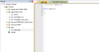

But when I try to add the same thing with KEIL uVision it gives a lot of error messages.
I'm generating my file in STM32CubeMX for Keil and then disabling the main.c build and adding main.cpp file

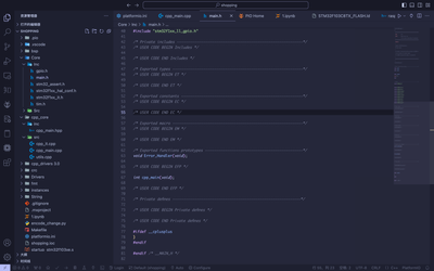

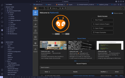

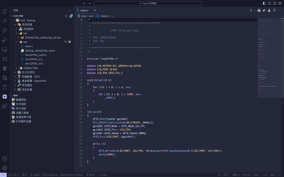

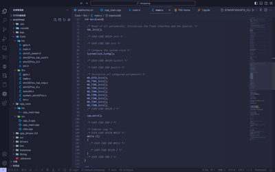

You can use the entensions named platformio or eide in VSCode, they are both support STM32
As for using C++ in embedded projects, this is certainly possible.
Next, I'll use platformio to implement mixed C/C++ programming in projects generated by STM32CubeMX.

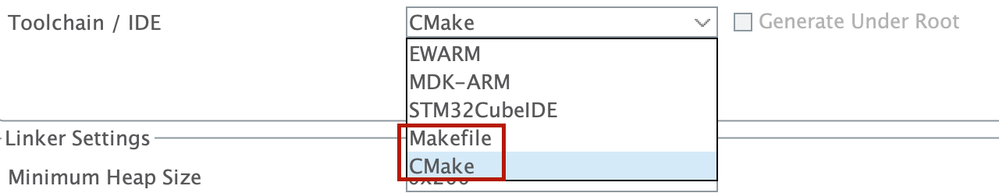

First, generate a template project with makefile, cmake or other which using arm-none-eabi-gcc.
Second, open the folder with VSCode, add a file named "platformio.ini" in root directory, and Incorporate the following:
; 在配置文件中分号开头为注释
; In the configuration file, a semicolon starts with a comment
[platformio]
; 将源代码的编译目录移到项目目录下,否则默认src下
; Move the compilation directory of the source code to the project directory, otherwise it will be under src by default
src_dir = ./
[env:genericSTM32F103RC]
; 配置平台和板子
; configure the platform and board
platform = ststm32
board = genericSTM32F103RC
; the option will add same drive to your project
; if your project is generated by STM32CubeMX and you use the option, there will be conflicts
; framework = stm32cube
; debug mode or release mode(unnecessary)
build_type = debug
; 编译配置-D是宏定义,-Idir是include文件目录,读者可按自己项目结构更改
; the start with -D are global macro definitions(by default 1 without "= sth.")
; the start with -I are include path
; using -std to choose your C/C++ version
build_flags =
-O1
-std=c++17
-Wl,-u,_printf_float
-DSTM32F103xE
-DUSE_FULL_LL_DRIVER
-Dregister=
-ICore/Inc
-Icpp_core/inc
-IDrivers/CMSIS/Include
-IDrivers/CMSIS/Device/ST/STM32F1xx/Include
-IDrivers/STM32F1xx_HAL_Driver/Inc
-IDrivers/STM32F1xx_HAL_Driver/Inc/Legacy
; 选择编译文件的所在路径,这里包含了源文件路径,启动文件,驱动库和rtos路径。如果+<*>便是路径下的所以文件,-<.git/>便是忽略.git路径下的文件
; these are source file(include .c, .cpp, .asm, .s)
; If there is a '/' after the path, all the source files in it are recursively appended
; the +<*> is add file, -<.git/> ignores files in the .git path
build_src_filter = +<Core/Src> +<cpp_core/src> +<startup_stm32f103xe.s> +<Drivers/> +<bsp/> +<fmt/> +<String/>
; 选择链接文件
; your link file
board_build.ldscript = STM32F103VETx_FLASH.ld
; 选择下载的仿真器,这里是选择的jlink,如果不设置默认stlink
; your upload protocol, by default with stlink
upload_protocol = cmsis-dap
; 字面意思
; your debug tool, by default with none
debug_tool = stlink

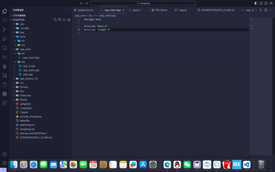

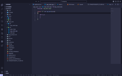

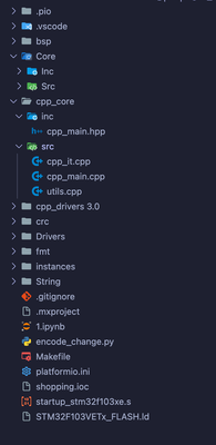

Second, add a folder(any name, I named it "cpp_core") with 2 subfolders named inc, src, and add new files cpp_main.cpp, cpp_main.hpp, cpp_it.cpp here.
Third, include "main.h" in cpp_main.h, add the defination of a function named "extern "C" void cpp_main(void)" in cpp_main.cpp, and its declare in main.h(not cpp_main.hpp). Add the function in your main function.
Now, You can use "cpp_main" as your new main function in C++.
