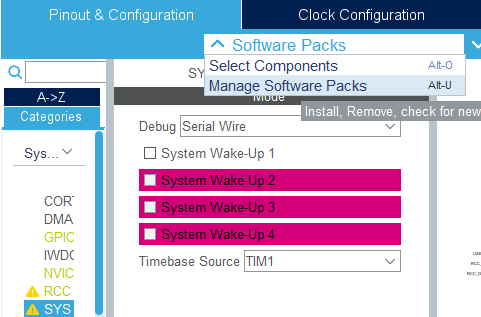

I tried to integrate it the cube by using the Manage Software Pack in the Device configuration tool:

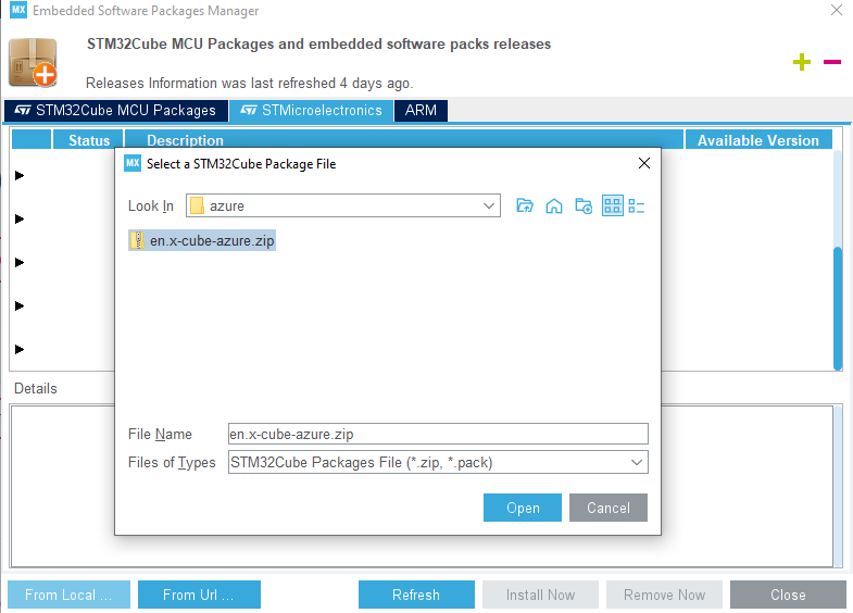

Then I select "From local" and select the en.x-cube-azure.zip file.
I get the following error:
any ideas how to import that expansion into the cube?

X-CUBE-Azure is not a "CMSIS pack". It is not installable with CubeMX.
Just unzip the X-CUBE-Azure .zip file at root of c:\ and run the project files for the desired development environment (EWARM, MDK-ARM, STM32CubeIDE).
