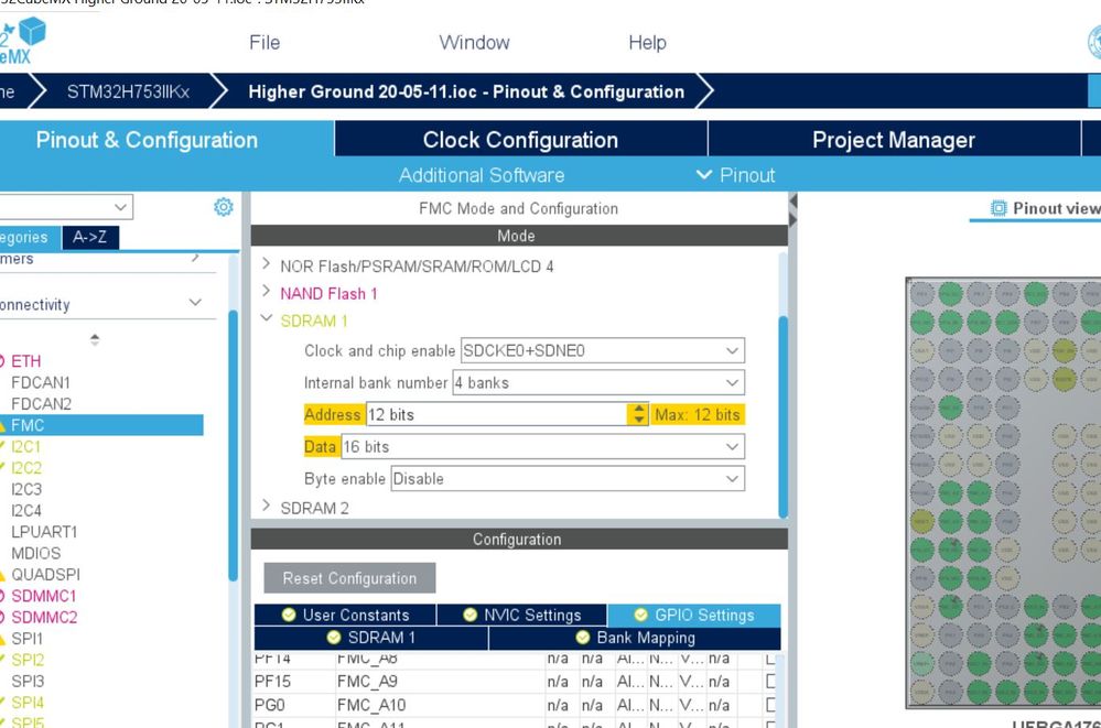

How do i assign FMC_a12 when stmcubemx limits me SDRAM to just 12 bits?
DReis.1
Associate II

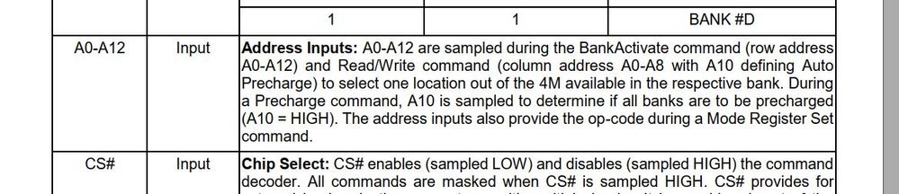

I am trying to program an STM32H7x3 device. My memory device (AS4C16M16SA) has address bits A0 - A12 and seems to need each of the 13 signals for access. However, when I go into STMCubeMX there is a max on SDRAM of 12 address bits.

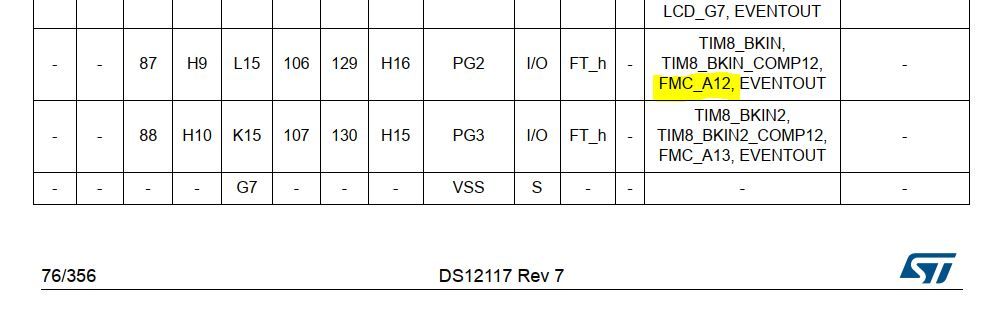

It seems like I should be able to assign the A12 address to pin PG2 based on Table8 in the DS12117 product document.
How can I override STMCubeMX to allow me to connect the full address bus?

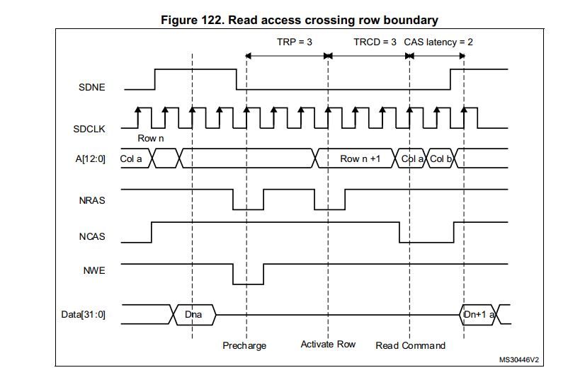

I see in the user manual that the diagrams call out for 13 bit address bus line:

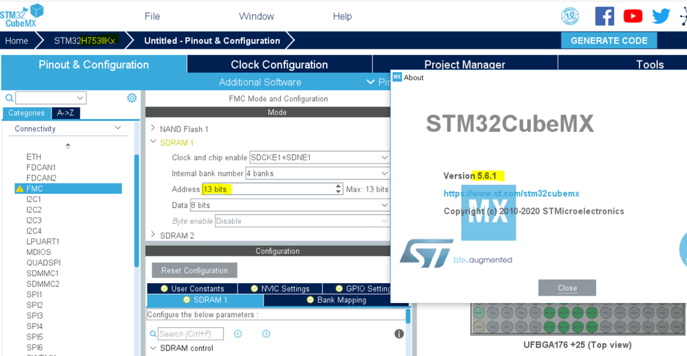

​Hello @DReis.1​ ,
Could you please check with the latest CubeMX version ? Max bits 13 on my side.
Thanks
Khouloud
Khouloud ZEMMELI
