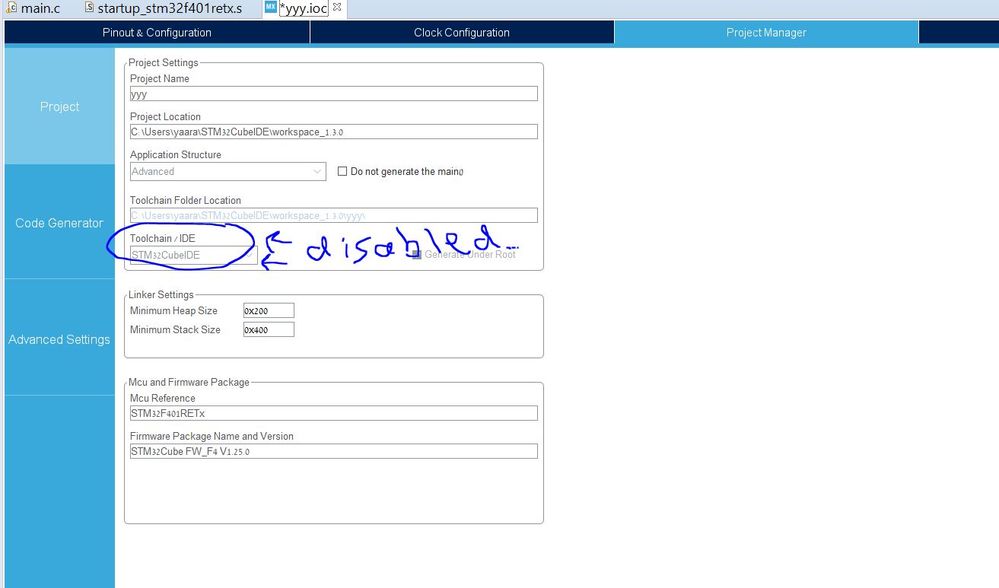

It looks like you're opening an .IOC file within STM32CubeIDE, so the choice is locked to STM32CubeIDE.
Open the IOC in standalone STM32CubeMX.
Side note: That has to be the worst font for readability I've seen in quite a while. Are you on Linux?

Thanks for the answer.
Can you please detail me step by step what i need to do ?
I didnt understand what you mean by "Open the IOC in standalone STM32CubeMX", how do i open it standalone?
2020-05-04 5:06 PM
Download and install STM32CubeMX from here:
https://www.st.com/en/development-tools/stm32cubemx.html
Run it.
Open your IOC file.
Probably save-as to another folder location.
Change Toolchain/IDE as desired.

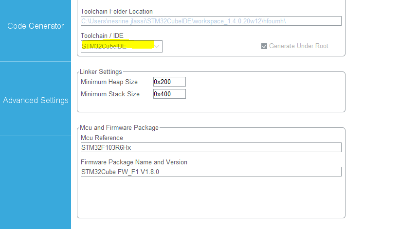

Hello @YBuch.1
When you create an STM32 project from the CubeIDE you can only use STM32CubeIDE as Toolchain/IDE (you will notice that only CubeIDE exists and that it is greyed out).

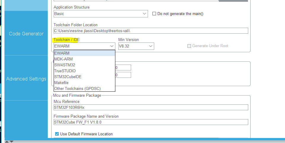

Otherwise, if you create a new .ioc from STM32CubeMX you can choose the IDE that suits your needs.

hi Nasrine,
thanks for the answer.
I tryed it. it is still disabled..
I did not managed to create another a new .ioc from STM32CubeMX like in the second example,
can you please send me a step by step instructions /screenshots of the stages that I need to do?..
2020-05-05 4:47 AM
Hi @YBuch.1
Create an .ioc from STM32CubeMX then, you can choose the IDE that suits your needs.
