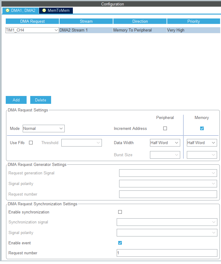

My guess right now is that my timer doesn't trigger the DMA transfer (or rather the DMA is not configured to be triggered by the right timer event).
Also it (TIM1) is configured as PWM generation, is it a correct way to use it for DMA ? I've seen some code from my company using OC mode rather than PWM but i'm not sure it is fitted for my needs.
