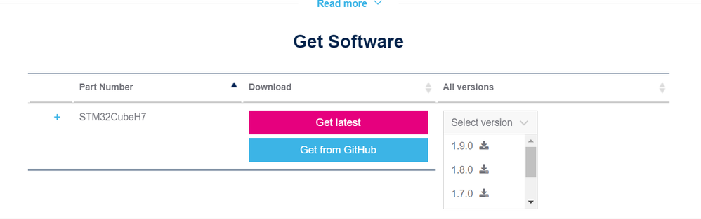

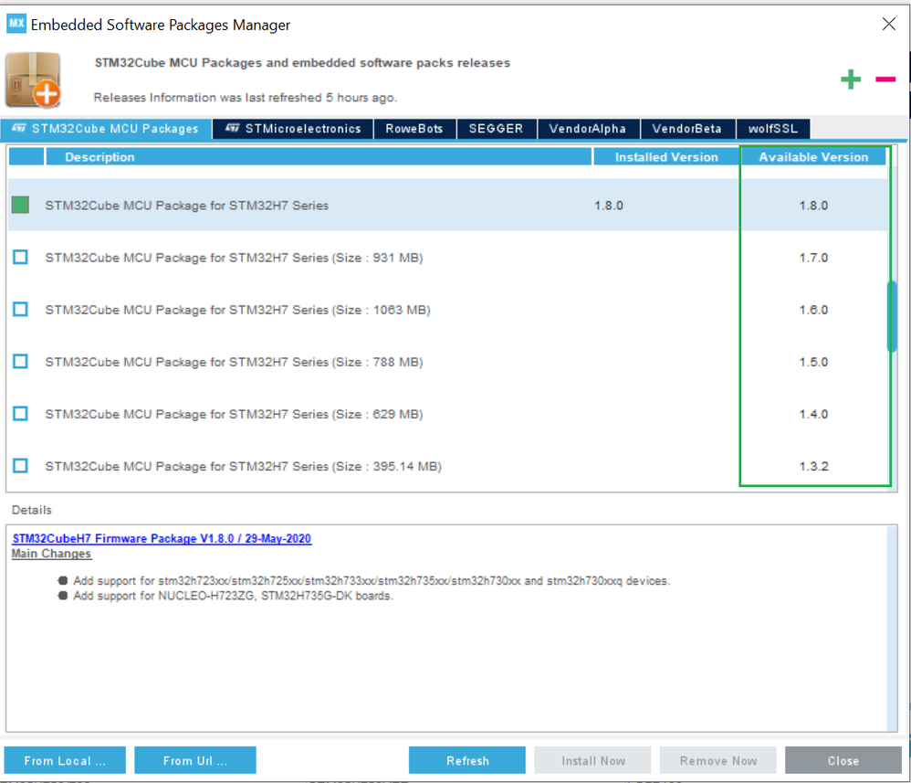

Actually each STM32 MCU and MPUs comes with STM32Cube MCU and MPU Packages including the hardware abstraction layer (HAL).
Assuming that you're using STM32CubeMX tool to generate your project, you can download STM32 MCU packages following the steps below:
Moreover, you can also download STM32Cube MCU & MPU Packages needed for you application and select the version you want to work with through this link :

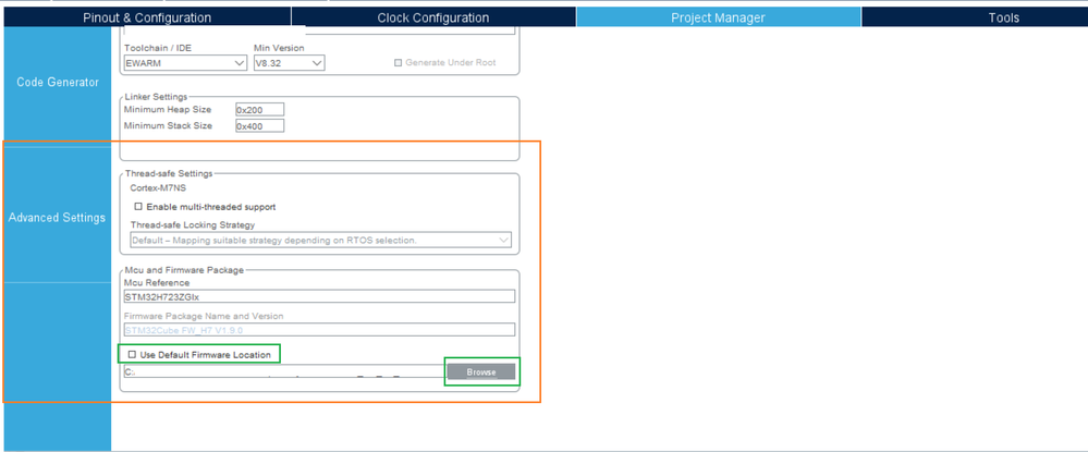

Once you've downloaded the STM32Cube MCU Package for your MCU , you can deselect the Use Default Firmware Location checkbox and browse the path for the downloaded firmware which will be used for you project:
You can refer to STM32CubeMX User Manual for further details.
