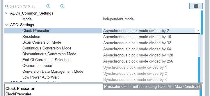

H743 ADC cannot be set to synchronous clock mode when AHB clock is 100MHz. the constraint seem to be wrong?
Zack
Associate II

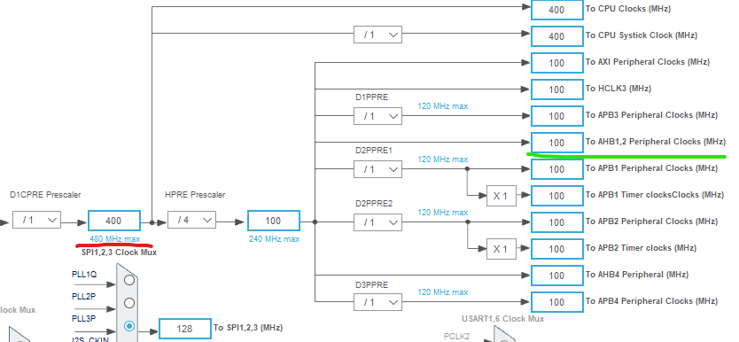

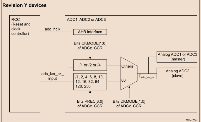

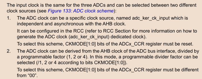

According to my understanding of the manual, setting ADC1 to synchronous clock mode requires selecting the clock source as AHB. The constraint should be the AHB1 frequency (green mark). However, CubeMX use D1CPRE clock (red mark) as a constraint. Synchronous clock mode optional only available when the D1CPRE frequency is low enough(In that case CPU clock is too low).
Is this a CubeMX bug, or I have misunderstood the manual?

I have tested this by myself using H743BITx,
Well, the synchronous/asyn clock mode divided by x should respect the Fadc min, max constraint :
the Fadc min, max constraint is :
according to an RCC Parameter: Power Regulator voltage Scale 1 or 2 or 3 we define a max and min Fadc constraint.
the asynchronous/synchronous clock mode divided by x can be selected only if :
Fadc min < ADCClockSynch/x < Fadc max & Fadc min < ADCClockASynch/x < Fadc max.
for example in our case we use STM32H7
-the ADCClockSynch =140 MHz
- the power Regulator Voltage Scale is set to power Regulator Voltage Scale 1 => that give us a Fadc min = 140 KHz and Fadc max = 36 MHz
we take the example of asynchronous clock mode divided by 4
1/
140Mhz / 4 = 35 MHz Fadc min= 140 KHz < 35Mhz< fadc max = 36 Mhz then the asynchronous clock mode divided by 4 can be used .
2/
280 MHz /4 = 70 MHz > Fadc max =36 MHz then asynchronous clock mode divided by 4 not allowed.
that why the not allowed divider are grayed in Mx.
Best Regards,
Khouloud.
Thank you for your reply
Is there a way to set ADC to synchronous clock mode in CubeMX when the CPU clocks is 400 MHz?
