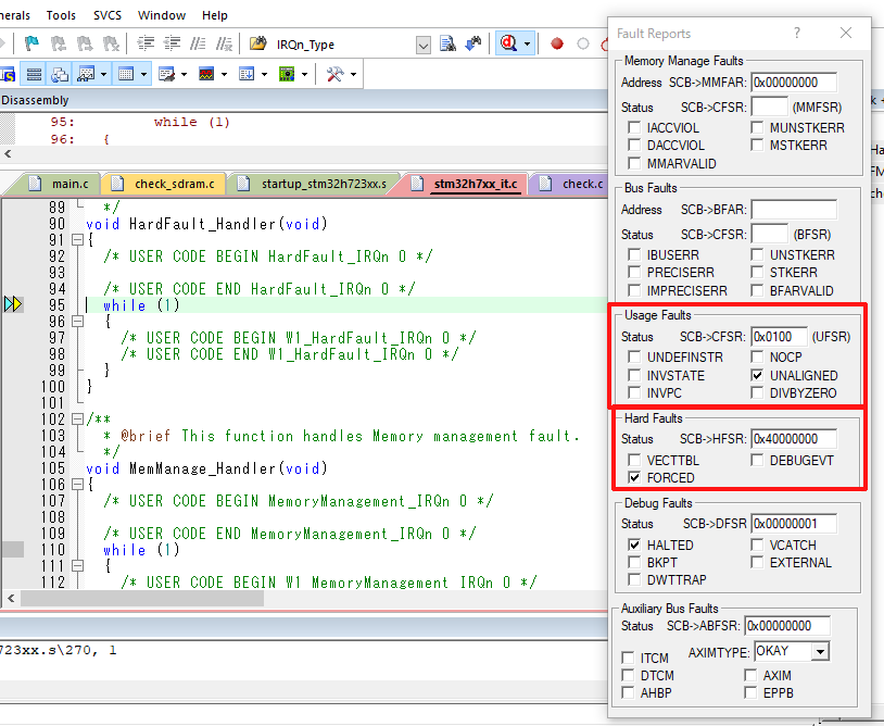

Using Cortex-M3/M4/M7 Fault Exceptions
I found this manual with details of hard faults.
About UNALIGNED
"There was an unaligned memory access," he said.

2022-04-06 3:48 AM
Look at what's actually faulting.
Have a proper Hard Fault handler that can quickly/effectively report detail about the point of failure.
Look at the disassembly of the code prior to the fault.
Likely got a LDRD or STRD against a pointer that isn't on a 32-bit boundary, and the compiler has optimized inappropriately.

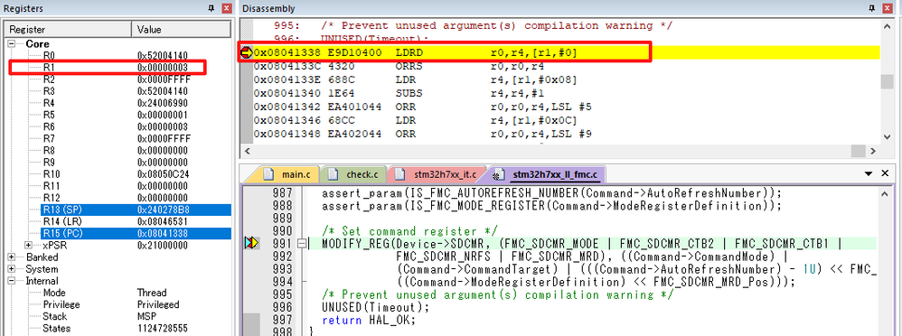

2022-04-10 5:28 PM
When I checked, it seemed that a strange address was being called.
