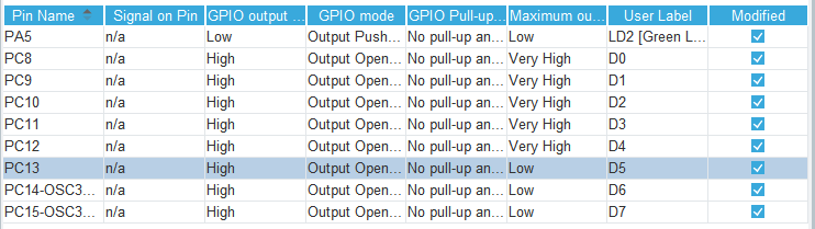

Hi All,
I am trying to set a few GPIO speed to High Speed but I was struct when PC13-15 are only able to set to Low Speed. May I know is this the STM32CubeMx bugs?
Or it is the STM32F446RE limitation? Please help.
Many Thanks

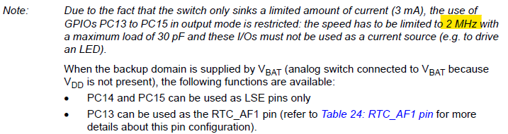

In the NUCLEO-64, PC13 is use to read User Button and PC14 and PC15 is connected to OSC32 crystal.
So I think due to the RTC HW configuration, it is restricted to run at a lower Clock Speed. I think 2 MHz still okay for my application as I would need the signal to rise in less than 100nS.

Andreas Bolsch
Lead II
RM, section 5.1.2. That's similar for most (all?) STM32 derivatives.
