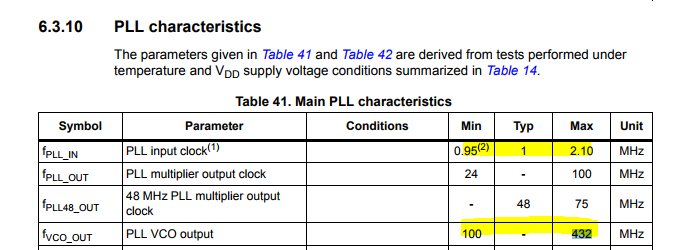

Thanks for highlighting this problem.In fact thereis no issue in document side but the issue is in the HAL driver.
I will check this with our development team & come back to you.Sorry for the inconvenience it may bring.
Please refer to the PLL characteristics table in your related datasheet (ieSTM32F411xC STM32F411xE datasheet)
