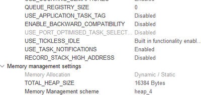

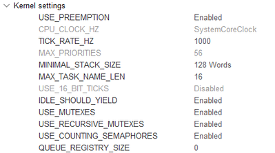

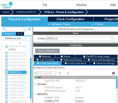

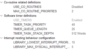

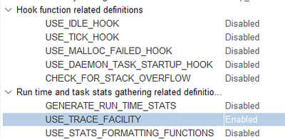

但是我无法设置 ENABLE_MPU==Enabled,我不知道为什么:
我的另一个配置是:
我需要设置哪些选项才能启用此选项?

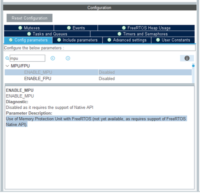

Hello @Wshuo.1
After clicking on the Enable_MPU message you can see the following message "Use of Memory Protection Unit with FreeRTOS (not yet available, as requires support of FreeRTOS Native API)."

I have already submitted a request to add support for the FreeRTOS memory protection unit MPU in CubeMX, as another user previously requested here.
So the internal ticket (Ticket 190405) is still under investigation and I will keep you updated.
