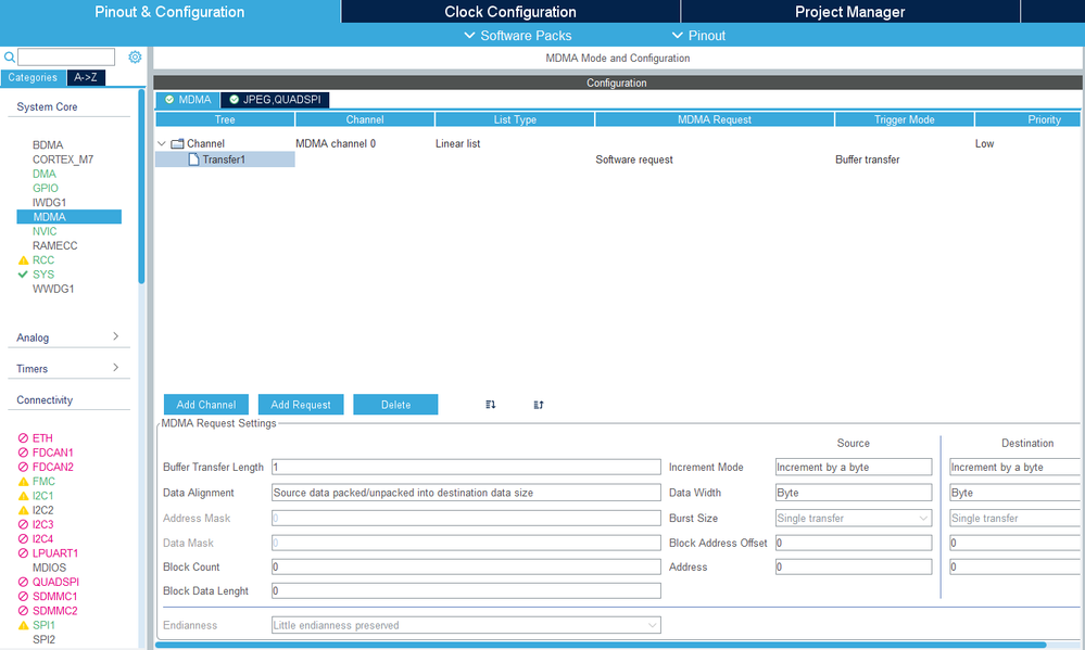

To offload the CPU we would like to use DMA. Calling the function HAL_SRAM_Write_DMA revealed that hsram->hmdma was not configured so I tried to connect these together using the Configuration tool. Usually, there is a DMA settings tab in the configuration but it is not visible for the FMC. Some googling later it seems we need to use the MDMA module so I have enabled it with a software request.
I was expecting to find a way to have the configuration tool generate the code for me to link the DMA to the FMC but found no way so I changed xx_hal_msp.c to

After some more digging I found that:
The MX_DMA_Init routine does not set the initialize Request type to MDMA_REQUEST_SW although I would expect that because of the Config tool setting. Maybe it's a wrong assumption. If I put that in manually, like so (inside the also previously non existing and therefore automatically deleted USER CODE block):
* Enable MDMA controller clock
* Configure MDMA for global transfers
* hmdma_mdma_channel40_sw_0
static void MX_MDMA_Init(void)
/* MDMA controller clock enable */
__HAL_RCC_MDMA_CLK_ENABLE();
/* Local variables */
/* USER CODE BEGIN MDMA_Init 0 */
hmdma_mdma_channel40_sw_0.Init.Request = MDMA_REQUEST_SW;
/* USER CODE END MDMA_Init 0 */
/* Configure MDMA channel MDMA_Channel0 */
/* Configure MDMA request hmdma_mdma_channel40_sw_0 on MDMA_Channel0 */
hmdma_mdma_channel40_sw_0.Instance = MDMA_Channel0;
hmdma_mdma_channel40_sw_0.Init.TransferTriggerMode = MDMA_BUFFER_TRANSFER;
hmdma_mdma_channel40_sw_0.Init.Priority = MDMA_PRIORITY_LOW;
hmdma_mdma_channel40_sw_0.Init.Endianness = MDMA_LITTLE_ENDIANNESS_PRESERVE;
hmdma_mdma_channel40_sw_0.Init.SourceInc = MDMA_SRC_INC_BYTE;
hmdma_mdma_channel40_sw_0.Init.DestinationInc = MDMA_DEST_INC_BYTE;
hmdma_mdma_channel40_sw_0.Init.SourceDataSize = MDMA_SRC_DATASIZE_BYTE;
hmdma_mdma_channel40_sw_0.Init.DestDataSize = MDMA_DEST_DATASIZE_BYTE;
hmdma_mdma_channel40_sw_0.Init.DataAlignment = MDMA_DATAALIGN_PACKENABLE;
hmdma_mdma_channel40_sw_0.Init.BufferTransferLength = 1;
hmdma_mdma_channel40_sw_0.Init.SourceBurst = MDMA_SOURCE_BURST_SINGLE;
hmdma_mdma_channel40_sw_0.Init.DestBurst = MDMA_DEST_BURST_SINGLE;
hmdma_mdma_channel40_sw_0.Init.SourceBlockAddressOffset = 0;
hmdma_mdma_channel40_sw_0.Init.DestBlockAddressOffset = 0;
if (HAL_MDMA_Init(&hmdma_mdma_channel40_sw_0) != HAL_OK)
Error_Handler();
/* MDMA interrupt initialization */
/* MDMA_IRQn interrupt configuration */
HAL_NVIC_SetPriority(MDMA_IRQn, 5, 0);
HAL_NVIC_EnableIRQ(MDMA_IRQn);
}The hardware pushes out one byte. Also, after that, the TCIF bit is set. The HAL_MDMA_IRQHandler is still not triggered.
If I change the trigger mode to:
hmdma_mdma_channel40_sw_0.Init.TransferTriggerMode = MDMA_FULL_TRANSFER;4 bytes (?) are pushed out, and the IRQ is triggered. The HAL_SRAM_DMA_XferCpltCallback is also triggered and I'm free to call for a new transfer.
Although it looks like progress it does not yet make me confident I have set everything up correctly to continue.
Hopefully it helps to identify where I'm going wrong, or point me in the right direction.
Another potential wrong assumption is that because I have set the Buffer Transfer length to 1, and increment with bytes, it's allowed to only send out one byte and expect normal behaviour. Is 4 bytes the minimum?
