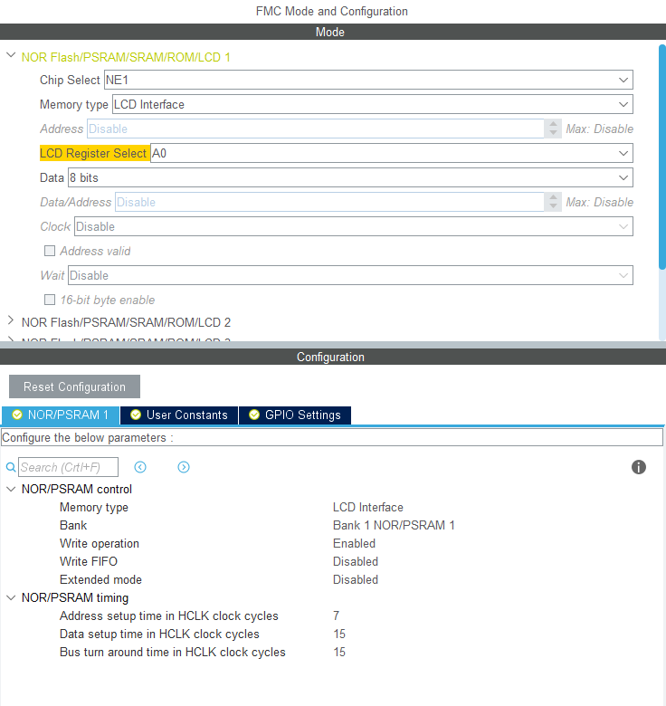

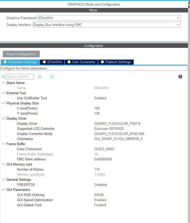

First of all I used CubeMX to configure my HW interface :

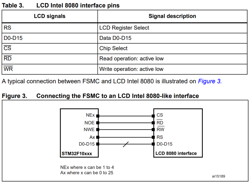

respecting A"N2790 TFT LCD interfacing with the high-density STM32F10xxx FSMC"
The generated code configured my FMC as :

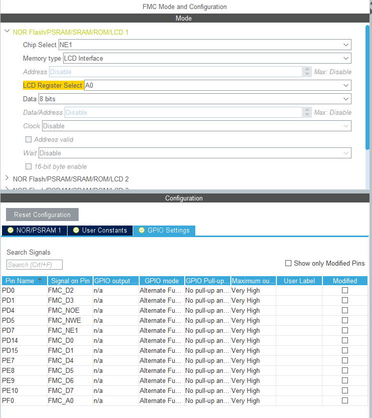

/** FMC GPIO Configuration
PF0 ------> FMC_A0
PE7 ------> FMC_D4
PE8 ------> FMC_D5
PE9 ------> FMC_D6
PE10 ------> FMC_D7
PD14 ------> FMC_D0
PD15 ------> FMC_D1
PD0 ------> FMC_D2
PD1 ------> FMC_D3
PD4 ------> FMC_NOE
PD5 ------> FMC_NWE
PD7 ------> FMC_NE1

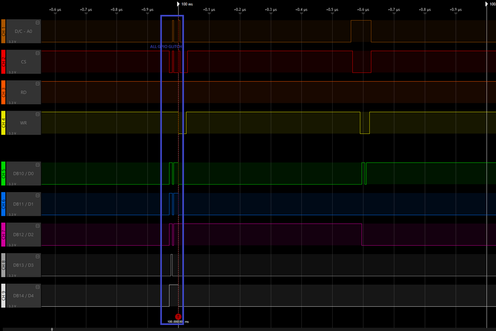

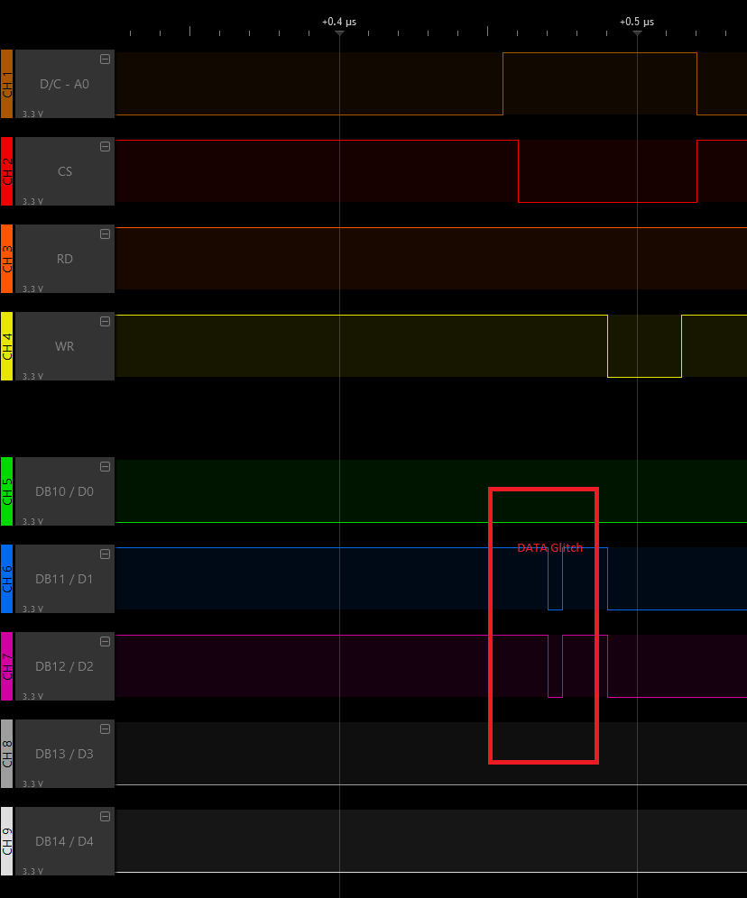

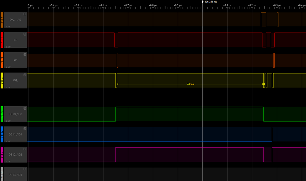

}But its actually not works for some reasons. I measured each channel of my display interface and indeed I can see some glitch on the differents GPIO :
Why I got this glitch at first sent data ?. Which I got later on data :
Then, I tried to play with delay to works correctly and reduce delay between command and data :
Timing.AddressSetupTime = 1;
Timing.AddressHoldTime = 1;
Timing.DataSetupTime = 1;
Timing.BusTurnAroundDuration = 5;
Timing.CLKDivision = 1;
Timing.DataLatency = 1;But the result is very strange ... :
Delay is exactly same. But read GPIO changes.... I don't even try to read. Why I got this result ?

2019-07-19 7:26 AM
Hello again,

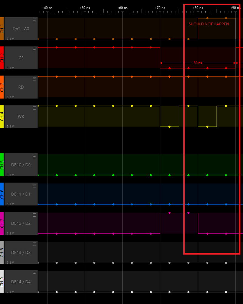

I successfully deleted the strange frame at start of transfer changing timing of AddressSetupTime to 0
Now my problem is that 2 write is done and Data/Sommand is changed. It shouldn't because I am trying to send only one command 0x04
I don't understand why I got this.
2019-07-19 7:44 AM
Ok, well it's hard to tell without the context of how you're doing the writes, but it looks like it folded two writes, perhaps via the write buffering the Cortex-Mx.
Perhaps you should using some fencing commands/operations to separate the transactions?
The glitches described in your first post seem to be related to the data bus changing drive direction, or barrel shifting content, what happens prior to the rising edge of -WR surely should be irrelevant to the device that is latching on that edge?
You also don't specify what display/controller you are using, so it makes diagnosis rather hard, and whether you're actually looking at the right problem.

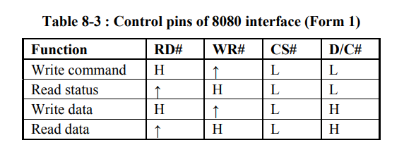

}As my current mode is Intel 8080 transfer is done at WR rising edge as described :
So indeed, its not a real problem to have a "glitch" before the transfert (means rising up of WR).
My real problem is the second post when it seems to the bus to turn arround but I don't ask to read (I only write a register with LcdWriteReg(0x04);
2021-08-23 2:30 PM
I think you declared the command and data pointers as uint16 causing 2 8 bit transfer.
