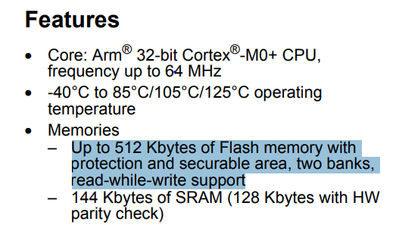

Mahmoud Ben Romdhane
Hello @TDK
Related to the Datasheet, the chip has two banks.
Thanks.
