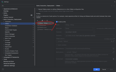

2025-08-06 9:11 AM - edited 2025-08-06 9:13 AM
I'm a CLion developer. I have just verified, starm-clang toolchain works with CLion as a charm.
You don’t need to specify any toolchains using the -D switch. Everything is already configured via CMakePresets.json. These presets are automatically imported into CLion as CMake profiles—you can see them in the screenshot. Simply delete the default "Debug" profile and enable the "Debug - Debug" one instead. This process is documented here:
https://www.jetbrains.com/help/clion/embedded-stm32.html#new-project
In the upcoming CLion versions this step will be done automatically.
If you have any questions related to CLion and STM32, feel free to reach out to me directly.
2025-10-03 10:21 AM - edited 2025-10-03 10:29 AM
What you need to do is just simply select the preset cmake profile (the gray ones) and click `enable profile`, then apply it.
That's all, and you will find your project working right.
Look through the documentation of clion for more information.
https://www.jetbrains.com/help/clion/cmake-presets.html
Happy hacking!
