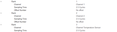

2024-03-07 8:00 AM
Unfortunately, I was unable to reproduce the problem with FW_G4 V1.5.2.
Could you please ensure that you have changed the channel name under Rank as bellow:

2024-03-07 8:00 AM
2024-03-07 8:17 AM
Thank you so much, I missed that when migrating the microcontroller!
