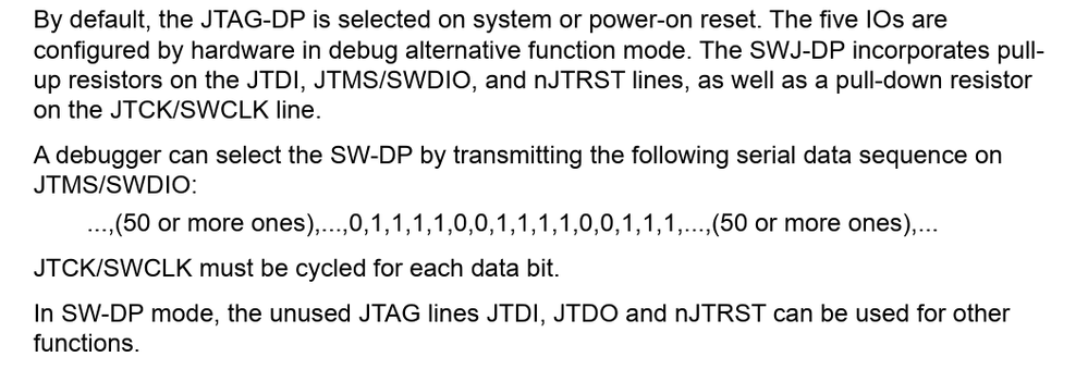

the st-link is connected to swd/swc ; at/after reset the chip has this working at this pins always, so it can work.
But if you set/use this pins for any other function, you loose connection.
You just can connect then "under reset", to flash the chip or set pins swd/swc for debug again, then you can debug the program you flashed "normal" again.
read in rm , debug...
