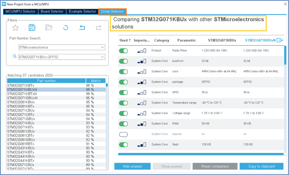

I would take this opportunity to present you the Cross Selector in CubeMX, it's an easy way to compare two or more Part Numbers:
