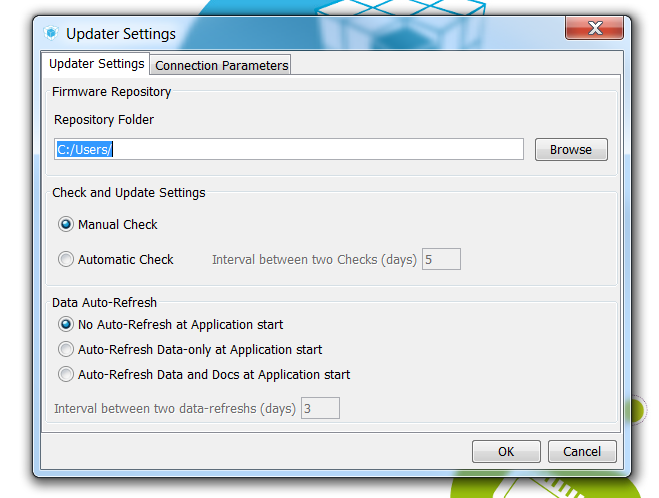

Like a lot of modern desktop computers I have a small, fast system disk and a huge data disk. This means that I really don't need gigs of Repository on my system disk, I want to choose where it goes.
In CubeMX 4.25.0, the Help->Update Settings->Repository Folder is greyed out.
Can this facility please be enabled so I don't have to keep manually moving downloaded HAL libraries and having to change the Repository path for every new project?

Hello
Gilks.Robin
,It's not greyed out in my case. Could you please share a screen shot showing the issue.
Khouloud.

Hi
Gilks.Robin
,You can change the repository path only if there is no project loaded.
Please close your current project then change your repo path
