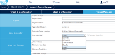

I would like to use the offical VScode extentention together eith STM32CubeMX.
The guide says I need to set up MX generator Toolchain / IDE to Cmake.
However I have no such option:
How could I use the extention with CubeMX?

Hi @yourigh ,
Try with the latest release (Version 6.11.0)

Hello @yourigh,
Please try with latest release of STM32CubeMx (V 6.11.0).
AN5952 This application note describes how to use CMake in STM32CubeIDE.

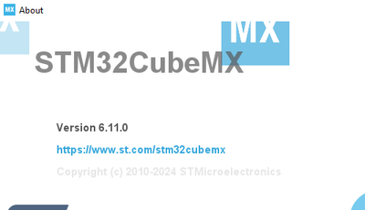

Thanks for the reply,
I do have exactly that version, under Windows. But I don't have the last option there. Do you have any recommendation what I can do?

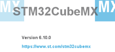

2024-04-16 12:55 AM
Thank you, it works.
I updated the Cube, but it did not go through because of the rights error, so I thought I have the latest one. After the successful update, it started to work.
