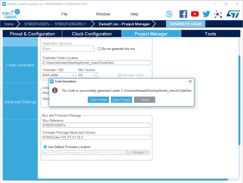

MCU reference : STM32F429ZITx
FW package name : STM32Cube FW_F4 V1.25.0
MDK ARM(Keil) version : 5.30
STM32CubeMX verision : 5.6.1
at that time, i want to create code but i can not.
just [the code is successfully generated under ~~ .but MDK ARM V4 project generation have a problem]
how can i solve this problem?
i can see other qeustion that may already have my problem.
but i cant sole...
ps. i try MDK ARM V4, V5, V5.27.. BUT ALL FAILED

Hello CMOON.1,
The max version supported by STM32CubeMX is java 11, normally there is no problem working with java JRE version 8.
I can't reproduce the problem from my side, It works well and the project is correctly generated (I am using MDK-ARM v5.29)
Please try to uninstall then reinstall MDK-ARM.

Hello CMOON.1,
I can't reproduce the issue, can you please attach your .ioc file to check the problem ?

NOTE: This problem may be related to the JAVA version installed on your computer . JAVA 13 is not not supported by STM32CubeMX, the max supported version is actually JAVA 11.

Thank you bro.
I attached ioc file.
And you said i should use java11, but I only downloaded java runtime enviroment version8 update251.
Does this matter?

2020-05-29 1:55 AM
is there a problem that i use MDK-ARM(Keil) lite version?

Hello CMOON.1,
BR,
Khouloud.

2020-06-06 11:16 AM
thank you
i solve the problem.
I tried to generate the code in Keil right from cubeMX, but when I create and set a project in keil, it is automatically connected to cubeMX.
After that, even if the code was generated in cubeMX, it was immediately reflected in Keil.
