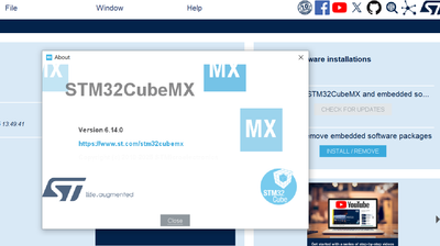

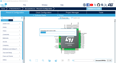

I've reinstall and upgraded to version 16.4, but I'm still stuck on the following screen.
Is there anything else I can try? Or if the CubeIDE has this feature built in.

Hello I have exactly the same problem. Installed latest version yesterday. Have you been able to solve the problem?

Thanks for info. In fact I got it to work today. I did two things:
1. Deleting .\Users\<username> and delete .stm32cubemx folder. Got the idea from Reddit...
After this I tested, no difference.
2. Filling in project name and location.
Tested again, Da da! working,
So probably the problem was on top of the keyboard.
