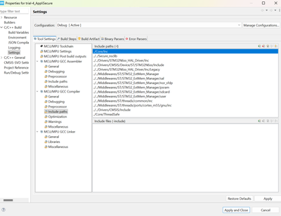

Also, compiler includes like "/Secure_nsclib" , "/Drivers/CMSIS/Include" did not get added into the Compiler Include Paths in the CubeIDE project that this CubeMX generates.

As for your second point, after reviewing the compiler include paths, I can confirm that both /Secure_nsclib and /Drivers/CMSIS/Include have been successfully added.
