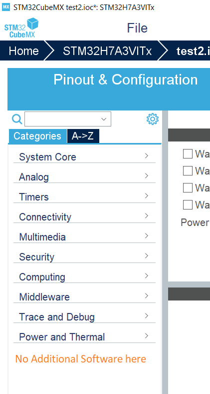

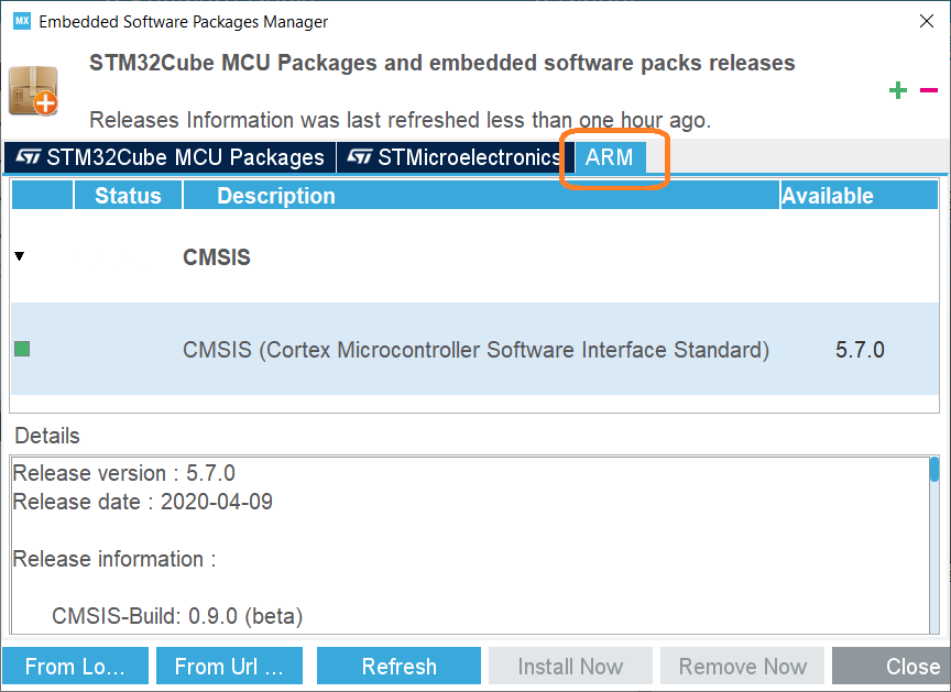

it should be possible to use the latest CMSIS (e.g. 5.7.0 from https://github.com/ARM-software/CMSIS_5/releases/tag/5.7.0) in CubeMX 6.1.1. After package installation I can see it on the list but it does not appear under "Additional Software" section. Actually, this section is missing entirely.

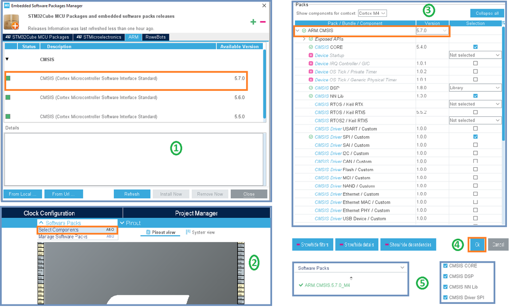

In fact, after the download and the install of the 5.7.0 CMSIS version, you have to select it under Software Packs, and configure it according to your need , click on Ok once you finish, and then the Software Packs will be appeared on CubeMX GUI, with your pack selected.
The image below explain more the steps described above to add your pack on CubeMX :

@Khouloud ZEMMELI Thank you so much. I overlooked this "Software Packs" option.
