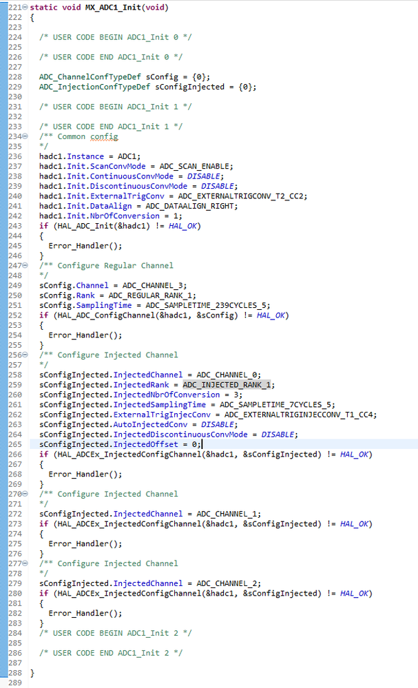

2021-10-04 6:02 AM
CubeMX just generates code, and the code you posted definitely shows different ADC_INJECTED_RANK_x for each. Could be a problem in the HAL library, but doesn't appear to be.

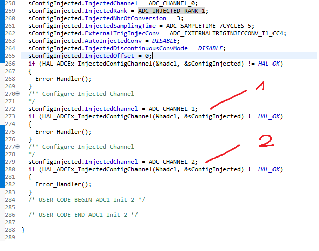

2021-10-04 6:28 AM
I'm confused. How does the code show different ADC_INJECTED_RANK's? It does show for version below CubeMX 6.3 but in 6.3 for me at least, it does not show.
In below picture at 1) and 2) there should be
sConfigInjected.InjectedRank = ADC_INJECTED_RANK_x;Or do I miss something here?

2021-10-06 8:27 AM
Hello @Framet ,
First let me apologize for the inconvenience that this regression may cause . You're right, CubeMX doesn't correctly generate MX_ADC1_Init() function: ADC_INJECTED_RANK_x is generated only for Rank 1.
This is reported internally to be reviewed. I'll keep you posted with the updates.
Internal ticket number: 115118 (This is an internal tracking number and is not accessible or usable by customers).
Even though this reply doesn’t directly solve the issue, I’m marking it as Best, since it will help clarify the current situation for other customers with the same question. I will post an update here once the issue has been fixed.
Khouloud.
