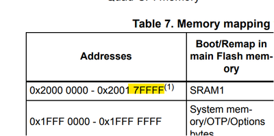

Another reference manual error: extra "F" in the address here:
2024-02-09 10:55 AM
There is this in the datasheet, the SRAM2 region has two mappings:
• 32 Kbyte located at address 0x1000 0000 with hardware parity check (SRAM2).
This memory is also mapped at address 0x2002 0000, offering a contiguous address
space with the SRAM1 (32 Kbyte aliased by bit band)
So it's possible to make the `RAM` region 160 kB, from 0x2000_0000 to 0x2002_7fff, by having both SRAM1 and SRAM2 contiguous. But if that's done, then the RAM2 mapping should not be there, as it aliases the end of the RAM mapping and will result in multiple objects assigned to the SRAM2 region.
The reference manual is still wrong if it has 0x2001_7fff as the upper limit. That's just 96 kB.
