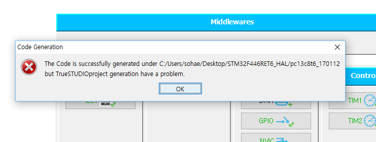

I'm using CubeMX 4.18.0 recently.
by the way,
Every time An error occurs when creating a TrueStudio project using the CubeMX 4.18.0.
Please, help.

Which version of
TrueStudio using ? Make sure to use the last version.
Maybe this is due to a long path issue. So, try to change with the short path. Do a clean then rebuild and import to
TrueStudio
.Please keep us informed on your progress

2017-01-12 1:58 AM
Long path problem.
Creating a project on a desktop created normally.
However, long path problem should be solved.
thanks.
2017-01-12 2:23 AM
After modifying a project created by another cubemx version of the projects,
the same error occurs after regenerating the code.

2017-01-15 7:02 PM
Hi
After updating cubemx to 4.19.0, the problem has been resolved.
I'll give feedback through more tests.
