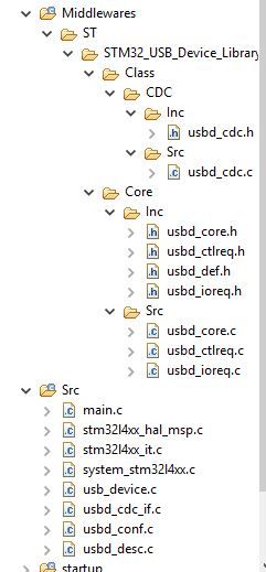

the Cube MX Version 4.22.0 don't generate the Middleware/ST correct. The folder tree is correct, but not filled with files.
I tested with the L475VGT and add the Virtual Com Port.
#middleware #cube-mx #usb-cdc #4.22.0Solved! Go to Solution.

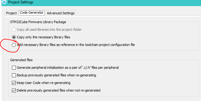

In my PC generates all files correct
Maybe you don't have full administrator rights to copy files to your folder.
Posible oolutions.
1. Add middleware as reference only.
2. Try to change the project folder name or/and path, and to take the proper rights to create files inside this folder.

I got full admin rights. and the 'ref' files don't fit it. :|
