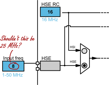

From this information, it is only logical to conclude that the 25 MHz crystal is connected to HSE input of the microcontroller. However, CubeMX fills in 8 MHz by default for the Nucleo board. It looks like that is plain wrong:

Naturally I fixed the bug by changing
HSE_VALUE
  from 8 MHz to 25 MHz:
    &sharpdefine
HSE_VALUE ((
uint32_t
)25000000)
Unfortunately, this messes up just about everything. My SPI clocks fall down to a much lower frequency, and the mbed serial logger outputs nonsense characters. Probably because the baud rate is no longer correct.
