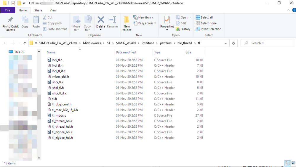

<USER_HOME>\STM32Cube\Repository\STM32Cube_FW_WB_V1.9.0\Middlewares\ST\STM32_WPAN\interface\patterns\ble_thread\tl

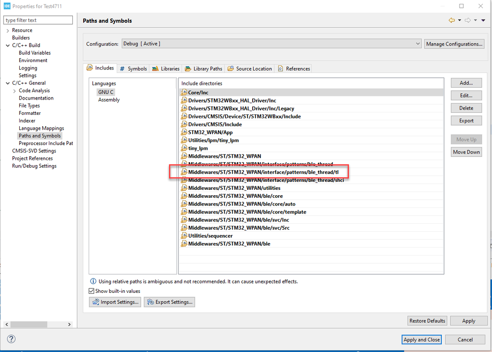

and it seems that path is in the INCLUDE paths of my project...?
Which is the very same directory where tl_mbox.c fails to compile.
Why isn't the .h file found?

I was able to manually fixing the problem by adding the very same include path once again but this time as a fully qualified path starting with C:\Users\...
I noticed that the bottom of the include path dialog (see above) mentions "Using relative paths is ambiguous and not recommended..." - which seemed to have cause the problem here. Yet all the other include paths apparently work as expected. So I'd still like to understand what the root cause is here, because using path relative to my workspace should work, right? Am I missing a system environment variable maybe?

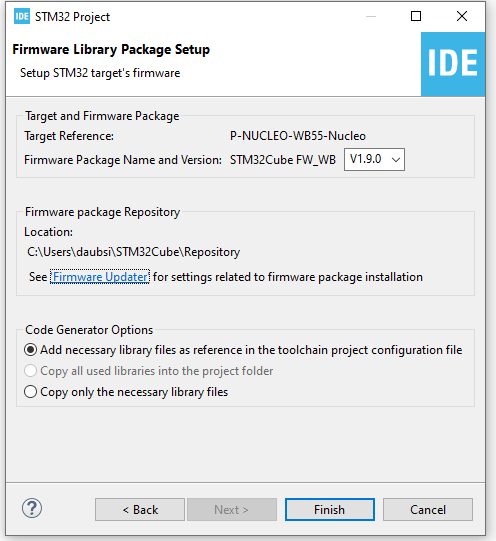

Please select copy all used libraries into the project folder under project manager .
This will resolve your issue.
Thank you !
Houssem
2020-11-05 8:56 AM
Dear Houssem,
you mean that one here?
It seems I cannot select it? This dialog appeared right after the "New-> New STM32 Project"
2020-11-06 12:42 AM
Dear @Community member ,
You are right. the copy all used ... is not supported for cube IDE.
Your issue is now fixed (with copy only ... option) and the fix will be available in the next cubeIDE/MX release.
Thanks your raising this issue, we are deeply sorry for any inconvenience this may have caused.
