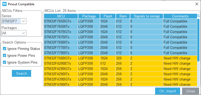

There is also another method using List Pinout Compatible MCUs available under Pinout-> List Pinout Compatible MCUs. 0693W00000JPu5OQAT.pngYou just need to edit the filter, click on search then select the wanted MCU and finally click on Import. This will also create a new project with the same previous config and it does not copy the added code or files created by the user. So you have to add it manually just like in the previous method.

Thanks for the quick answer. The List Pinout Compatible MCUs is a cool tool but it does not work for other packages and the change from NIH to BGT. But still the MCU behind is exactly the same and the datasheet is also the same for both MCUs. The project import worked good.

Hello @Community member​ ,
It is actually a little bit risky to do such thing but only when the MCUs are not from the same serie. In your case, it is absolutely safe.
