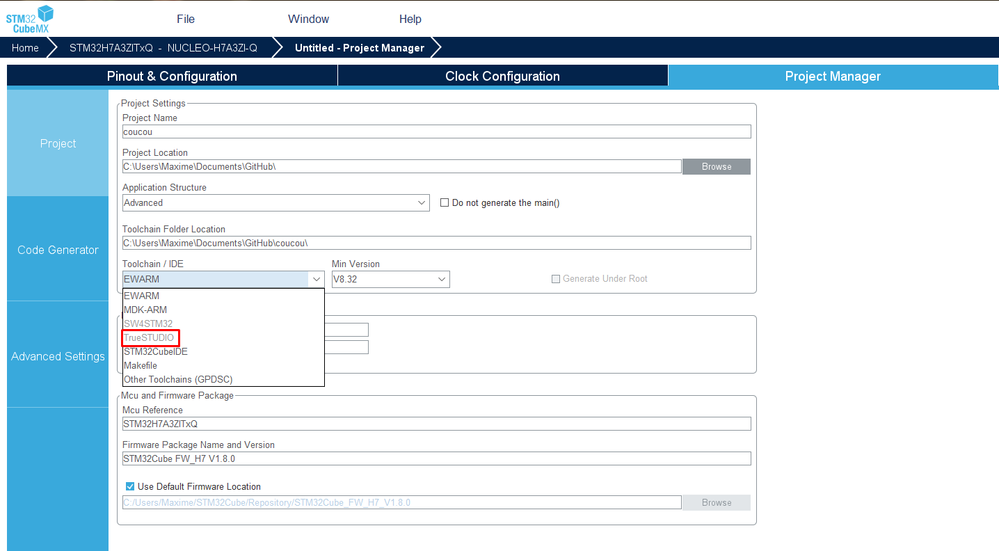

I use a STM32H7A3ZI-Q board, and I can't select TrueSTUDIO as IDE in the project settings ... Any idea ?
Thanks for your support.
Maxime

Hello @Maxime
The TrueStudio is no more supported for all new series, I recommend you to use the CubeIDE instead.
Thanks for your feedback, Khouloud

2021-01-05 8:35 AM
This is a bad new...
2021-01-27 5:58 AM
Very bad news. ST, until you get CubeIDE debugger stable, please do not abandon TrueStudio.
