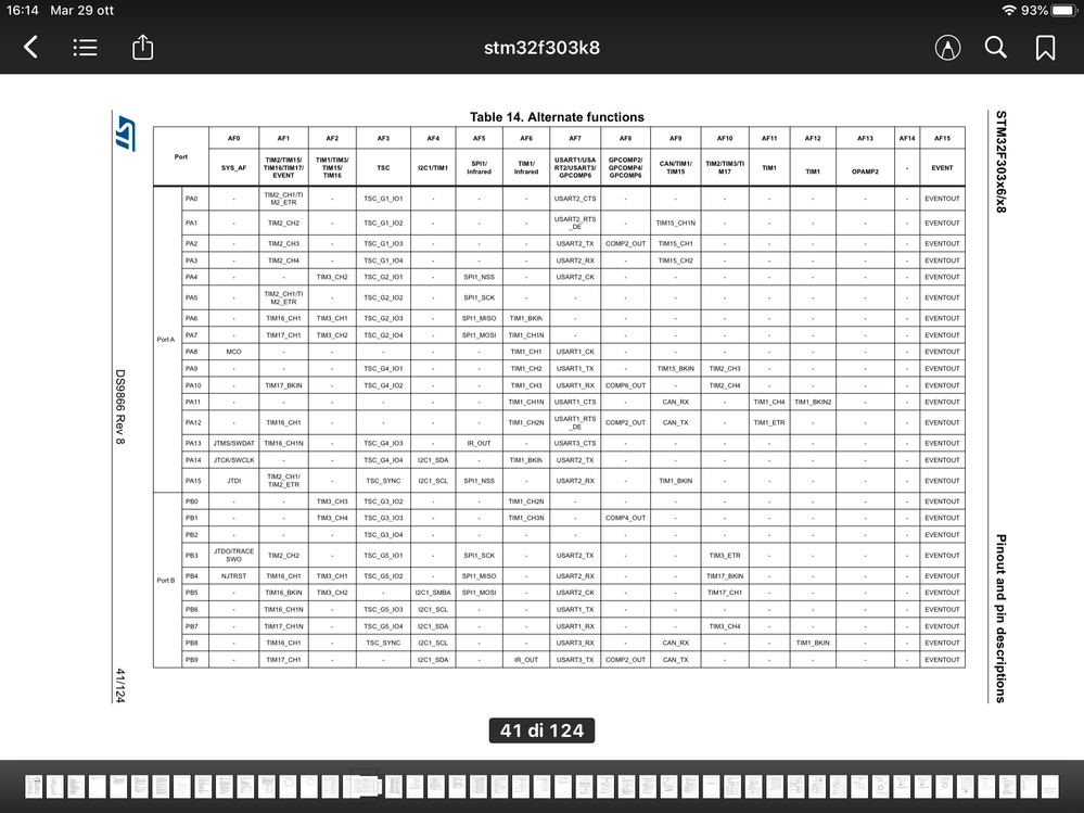

GPIOB->AFR = 0100 1000 0000 0000 0000 0100 0010 0000Looking at the port configuration bits for PB7 (SDA) and PB6 (SCL), MODER bits are 10 for both, they are in alternate function mode, good.
Alternate function number for PB7 is 4, this is the AF number for I2C1, good.
Alternate function number for PB6 is 8, this is wrong.
See Table 14. Alternate functions in the datasheet. AF8 is not defined for PB6, so anything might happen there, it might even accidentally work.
Find out what code puts 8 in bits 24-27 of AFR[0], and correct it. The AF value for PB0 (AF0) is undefined too, and there is no reason to set PB2 to AF8 when it's not configured to alternate function mode, something is writing junk all over the place. I'd suggest going over all GPIO registers, and checking their values against the datasheet and the reference manual.
2019-10-29 8:17 AM
Thanks for your answer,
so If I understood correctly the wrong value AF8 should be replaced with AF4 according to the picture.
Thank you
