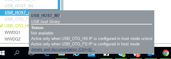

As described, USB_HOST_M7 is active only when USB_OTG_HS IP is configured in host mode or/and Active only when USB_OTG_FS IP is configured in host mode.
So, 1. activate USB_OTG_HS then USB_HOST_M7 will be supported .

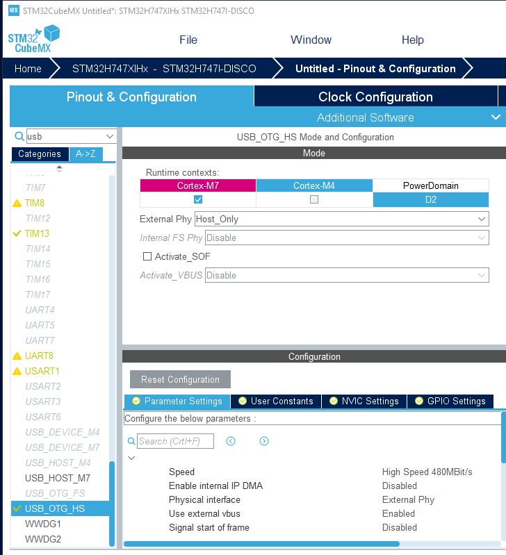

2020-01-27 5:44 AM
Hello Nesrine,
Thanks for your reply, but I don't have any problems with USB HS Middleware, that works for me without any problems. The problem I'm having is that I can't enable "USBHS_USE_OS" option in CMSIS_RTOS section in USB_HOST_M7 Middleware configuration.
