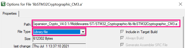

6. Add the path of “libSTM32Cryptographic_CM3.a�? and modify the file Type to Library file as shown in the below figure:0693W00000QNZK6QAP.png7. Click Ok.

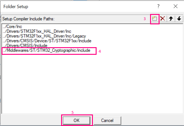

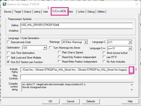

8. Select “Options for Target�?, choose C/C++ (AC6) and add path by following these steps in the below figures:
0693W00000QNZKQQA5.png0693W00000QNZKpQAP.png8. Copy the cmox_low_level_template.c file from the interface folder to your project specific source folder and rename it into cmox_low_level.c.
